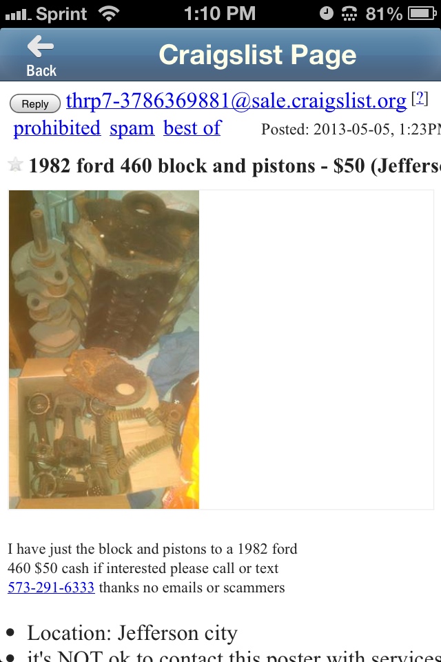

    So I found a pair of dove head on Craigslist for 350, and I see some c6 transmissions for about 275 or I could go to the junkyard, pull a 460 and c6 and rebuild the 460 with dove heads and a balanced crank for 50 bucks on Craigslist. Dove heAds, a crank from a 1968-79 style?
    I found some stuff let me know if it will work together, I know the block shown will need work done to it.
    [​IMG] -crank
    [​IMG] -dove heads
    [​IMG] -block, another crank, heads, etc
