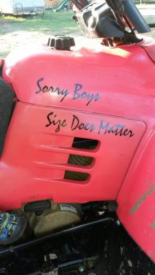

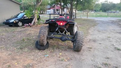

    That's right I did it. My wife wanted a 4 wheeler that would turn lots of heads so I built her one.
    It started life as a 2000 Polaris xpedition 325. I got it from a friend with the rear diff in pieces.
    So I found a set of axles from a Suzuki samurai and put the two together Lol.
    She decided to paint it to match her expedition.
    Right now its running some 32x11.50 Ground Hawgs I had here but I'm looking to put some 35s on it soon.

    A few pic of the build.

    Power is good. I can hold the front brakes and dig a hole with the one back tire. I've got a mini spool to out in it after this weekend. I really want some 35s or 38s to go on it.
    We are going to a mud bog this weekend so it'll get plenty of testing.
    Sent from my SAMSUNG-SGH-I537 using Tapatalk 2
