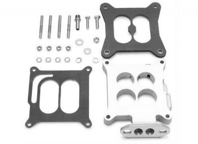

    Ha, found it !
    #8053 is a !" carb spacer. EGR capable
    or looks like it can be blocked off for racing.
    Summit has it for $81.88
