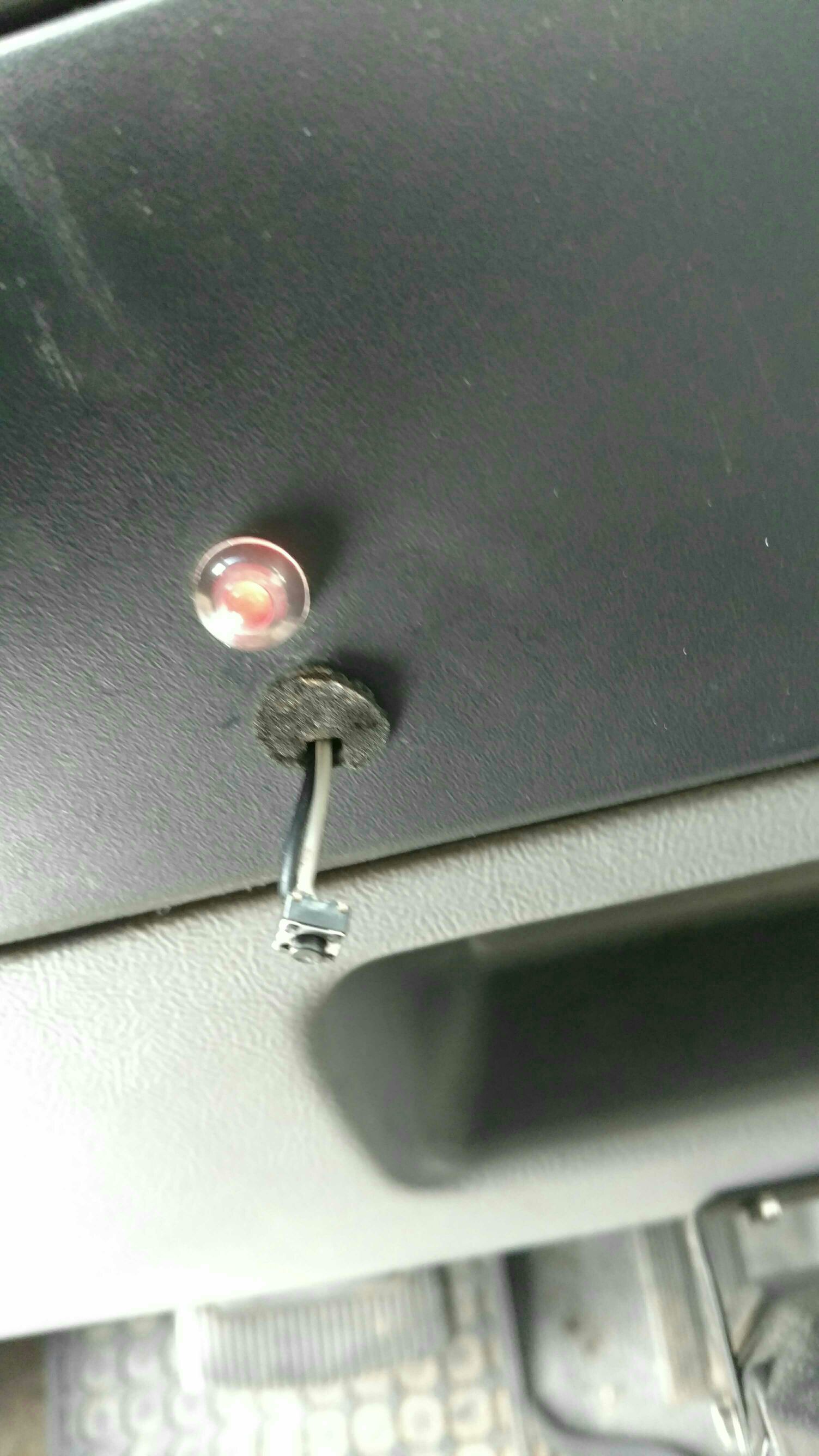

    Well I jumped the gun a little bit looks like somebody did install something even though he said it's stock no idea what this light goes to or what that button switch is for [​IMG]

  7. Roush PSD Interceptor
    58
    Yep, you have an aftermarket
    security system.
    I'd say your no spark issue has something to do with the security system.
    They may have the ignition (coil power) disabled by a relay thru it.
  8. Roush PSD Interceptor
    58
    That switch usually engages valet mode which disables the security system.
    Try pushing that button and turn the ignition key on then release button and turn ignition key off.
    See if light above button goes off. ( Disable security mode )
