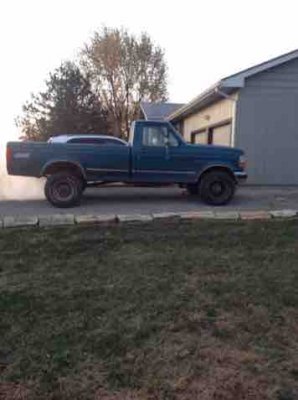

    Hi guys, I'm new here and am a high school student. I have a 96 f250 (old body style) and my front end sits about 4.5in lower then my rear end. As far as I know everything is stock so it should sit close to level right? I mean I know the front is supposed to be a little lower but 4.5in? It has a leaf spring front suspension that basically looks reversed. It literally looks like someone took them and flipped them. So my question is how to fix it? Can you actually flip leaf springs? Are they just weak and need replaced? Or is that a normal ford thing? I will post pictures when I can. Thanks for any help, Josh.

  6. flattracker57
    flattracker57 Junior Member
    9
    Nov 12, 2014
    Here's how it sits, it was a little too dark to get the actual leaf but I'll try to take a picture after school.
  7. iowaredneck
    I would guess you have worn out leaf springs
  8. Roush PSD Interceptor
    58
    Almost looks like rear air shocks
    pumped way up.
    Second vote on the front springs.
  9. Bdons-SD
    5,905
    310
    X3
