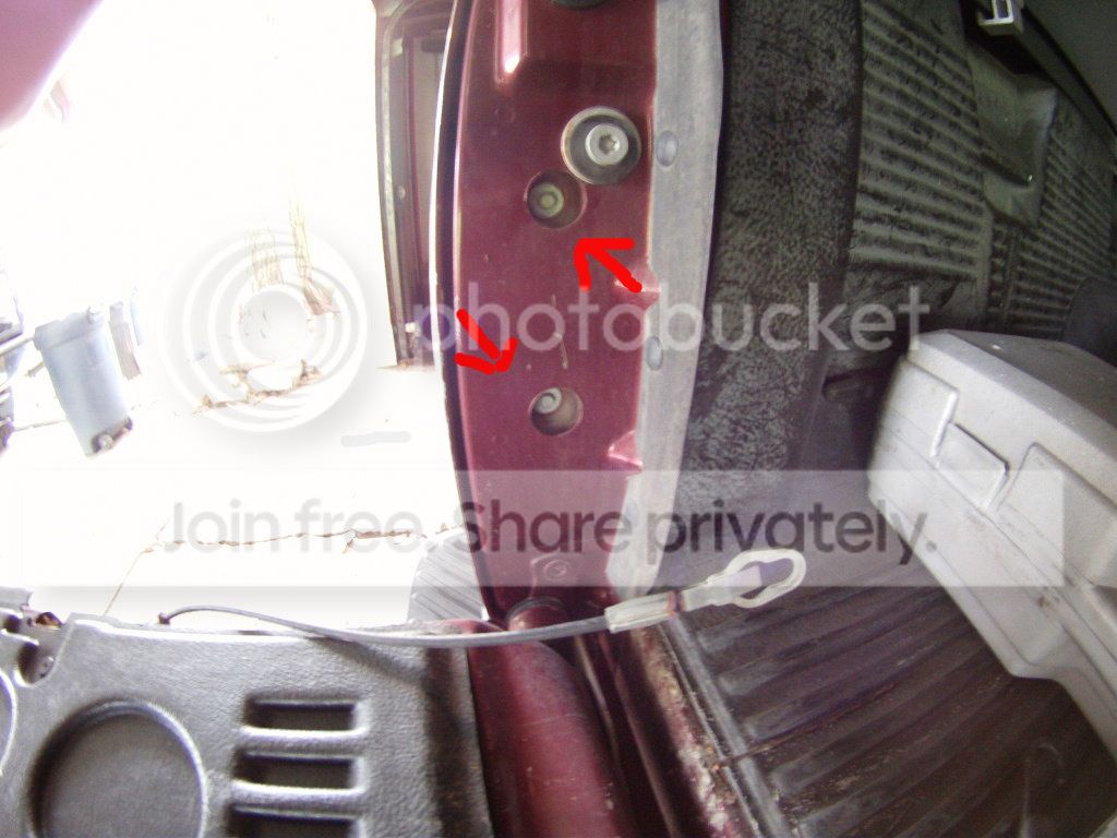

    You'll need a 8mm socket, and to remove the wire(?) that supports the tailgate when its down. Do one side at a time, or you may damage the tailgate.
    Remove the two bolts shown

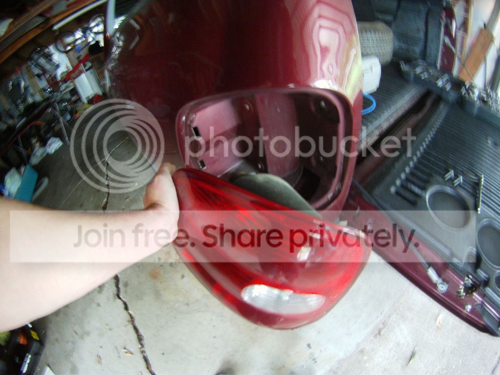

    Once removed, pull the light assembly straight back from the truck. You may need to wiggle it a little bit to get it to move.

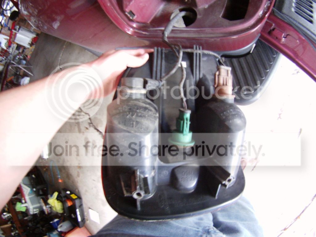

    Unhook the clips as necessary, and you're done!
    Follow in reverse to re-install.
