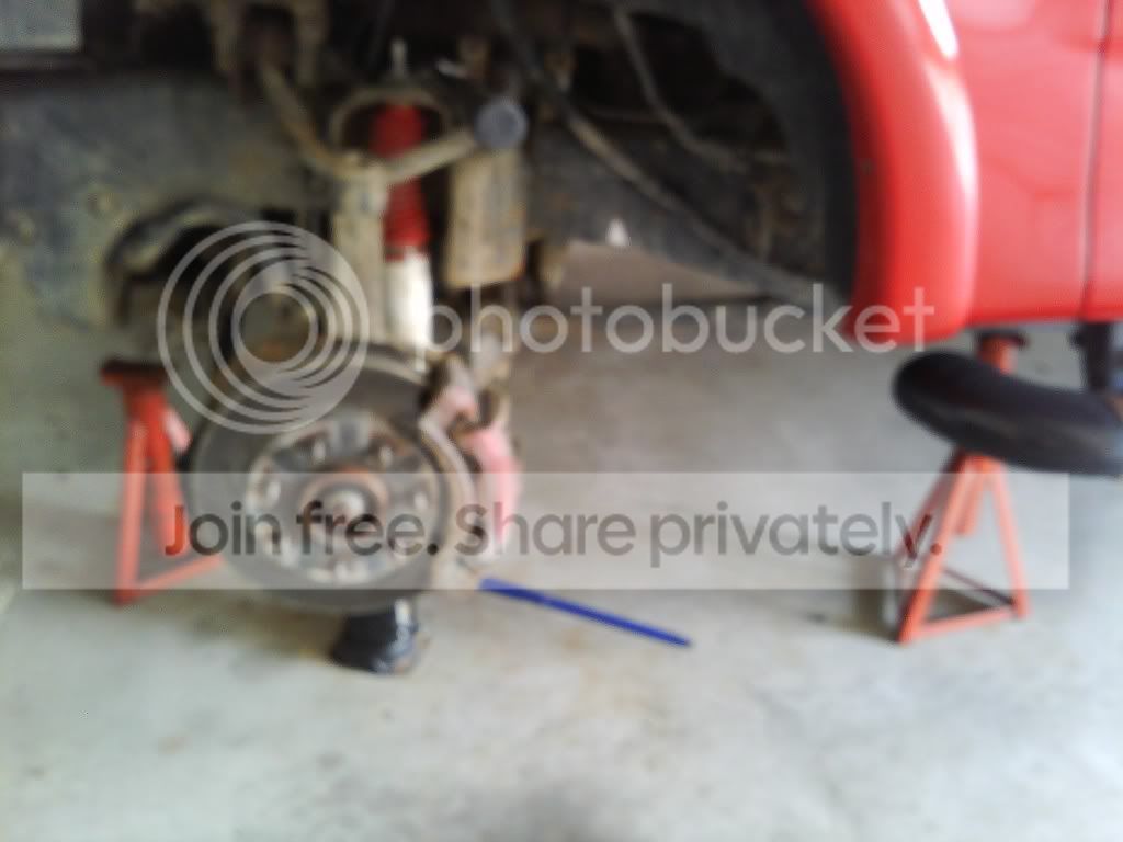

    start by putting your wheel chocks down, loosening your lug nuts, jacking the truck up and setting it down on a jack stand. next take your tire off.

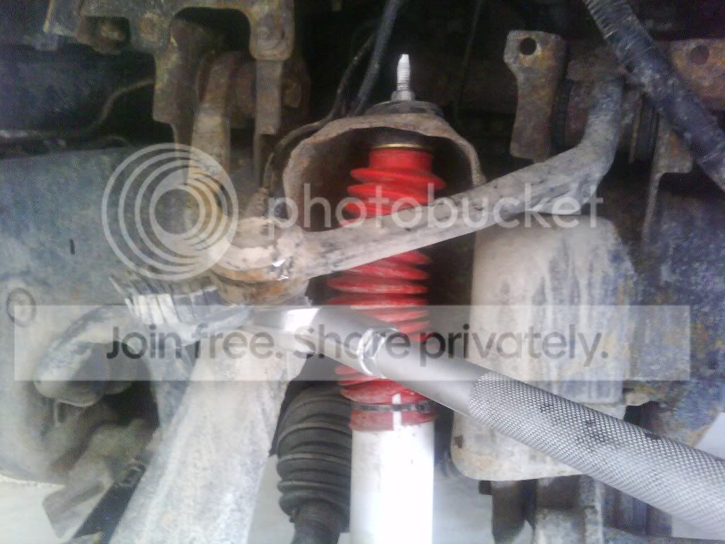

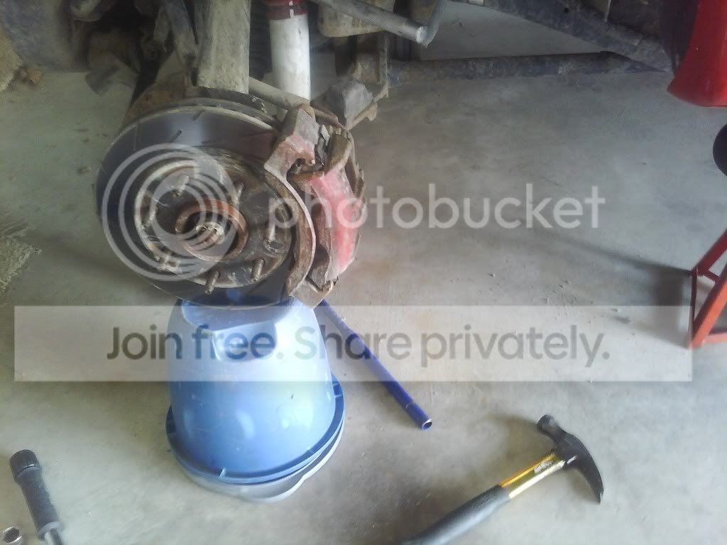

    i started by jacking the control arm up enough to unload the ball joint, also get something to put under the lower control arm so when you pop the ball joint out the lower arm and knuckle dont fall. take the castle nut off of the ball joint stud (13/16) and then put the pickle fork between the ball joint and the knuckle. hammer away untill it pops out.

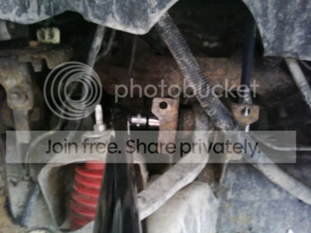

    After the ball joint is popped out you have to take the 2 bolts out of the control arm, pretty sure they were 13/16s as well. you will need two sockets (or a wrench)

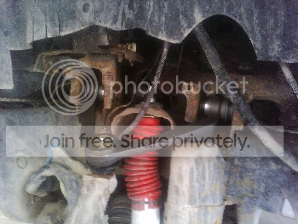

    once the bolts are out of the control arm you can take the old arm out. you may need to hammer it out. i used the pickle fork to pry from the bottom to push the arm out of the mount. before loosening the bolts you may want to make some alignment marks. the control arm bolts go through a slide which allow you to push the control arm in towards the engine or pull it outward, this will effect your camber. i forgot to mark mine but there is a mark where the washer for the bolts was sitting so i made sure the washer lined up with its original marks before tightening.
    once the arm is out take your wire brush and brush away any rust around the mount area. it will make it easier to put the new arm in place.
    Make sure you have the new arm the right way and slide it in the mount. you may need to hammer it in. once you work it in put the nuts and bolts back through the new control arm and tighten the nuts/bolts to 120 ft/lbs with your torque wrench.

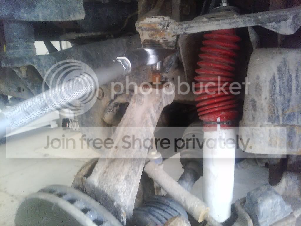

    then put the stud of the new ball joint through the knuckle and put the castle nut on. this new nut with my Moog arm was much bigger than the factory nut. it was a 26mm nut. Torque this nut to 75 ft/lbs and grease it. (before putting the stud back into the knuckle make sure the mount hole is not out of round, also make sure that the grease boot on the ball joint is positioned right. there may be a small grease release on the boot, put this part of the boot away from the wheel assembly to avoid grease getting on rotors)
