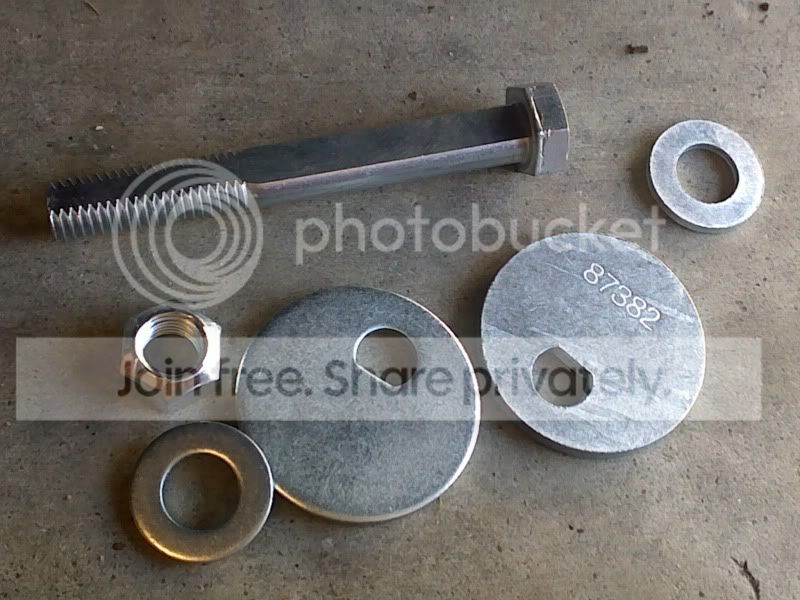

    Your kit should include 4 bolts and 8 cams 4 nuts and 8 washers
    First start by removing wheels and properly securing the vehicle. Remove upper control arm nuts and remove bolt. There will be 2 bolts per control arm. EDIT::: I forgot to originally add the fact that there is no need to take the entire control arm loose. Just do one of the two bolts/adjusters at a time. In other words, do the front part of the control arm, then finger tighten. Move to the rear and install bolt and cams and make final adjustments, tightening all the nuts to factory specs.
    Place the cam on the bolt first, then a washer. Insert bolt and cam and washer into the control arm.
    Install washer, cam and nut in that order. Finger tighten and repeat process on second control arm bolt.

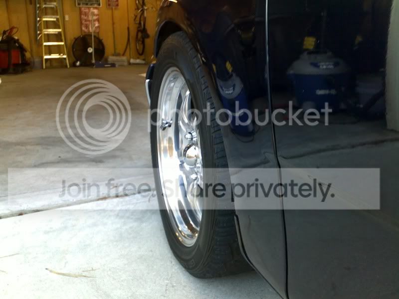

    Since I don't have the equipment to actually do an alignment I just eyeballed the camber and set it as best as I could. I have an appointment with the local tire/alignment shop in the morning so it doesn't matter too much. I wouldn't suggest doing this unless you plan on getting a proper alignment in the near future.
    Viola, now my wheels are sitting straight and are no longer bowed in at the top. Much better. One benefit to the Eibach kit is it allows a wide range of
