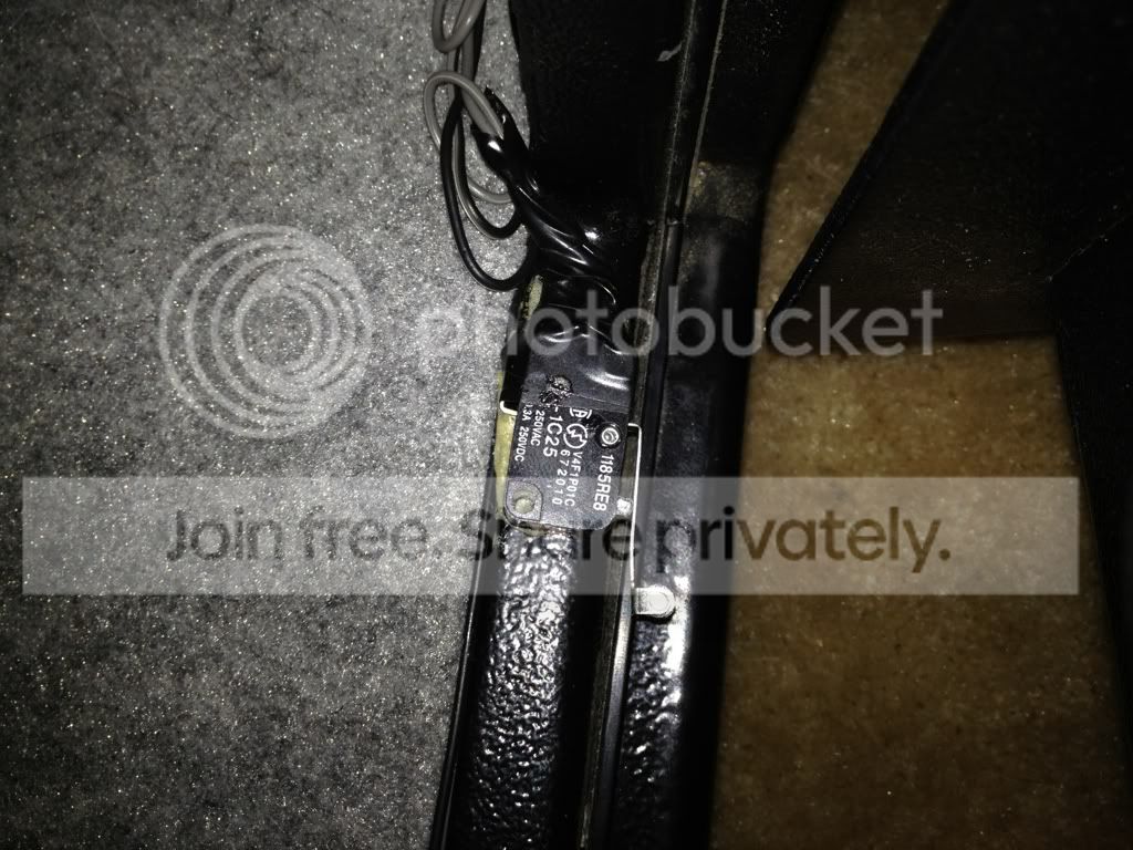

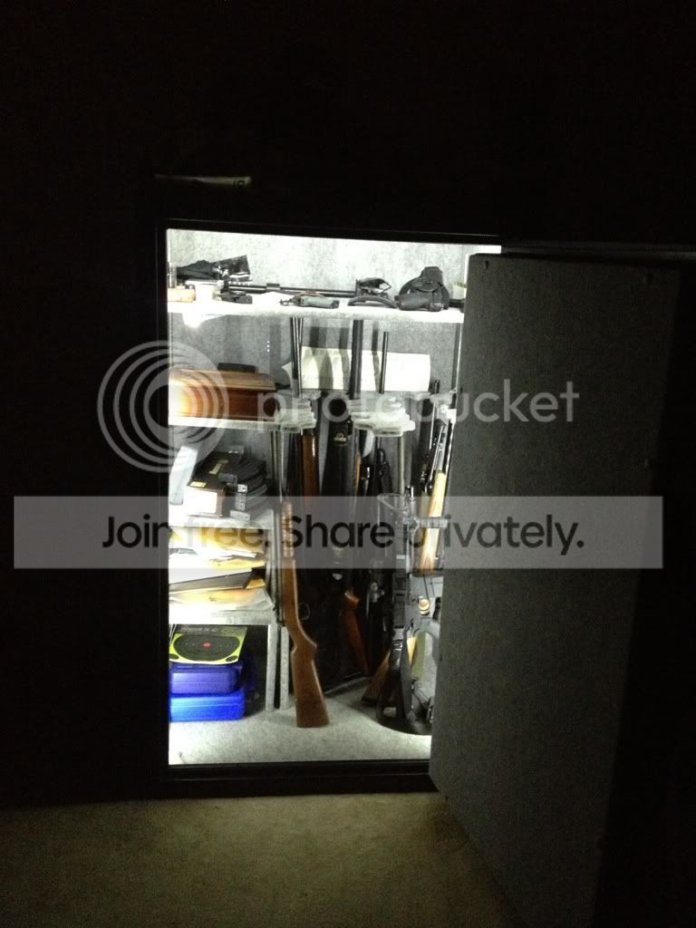

    I took the led strip, which comes with 3M sticky on the back, and lined the inside door jamb of my safe starting at the bottom right corner, up and across the top and then back down the left side. I used the roller switch listed below to turn the lights on and off with the open/ close of the door.

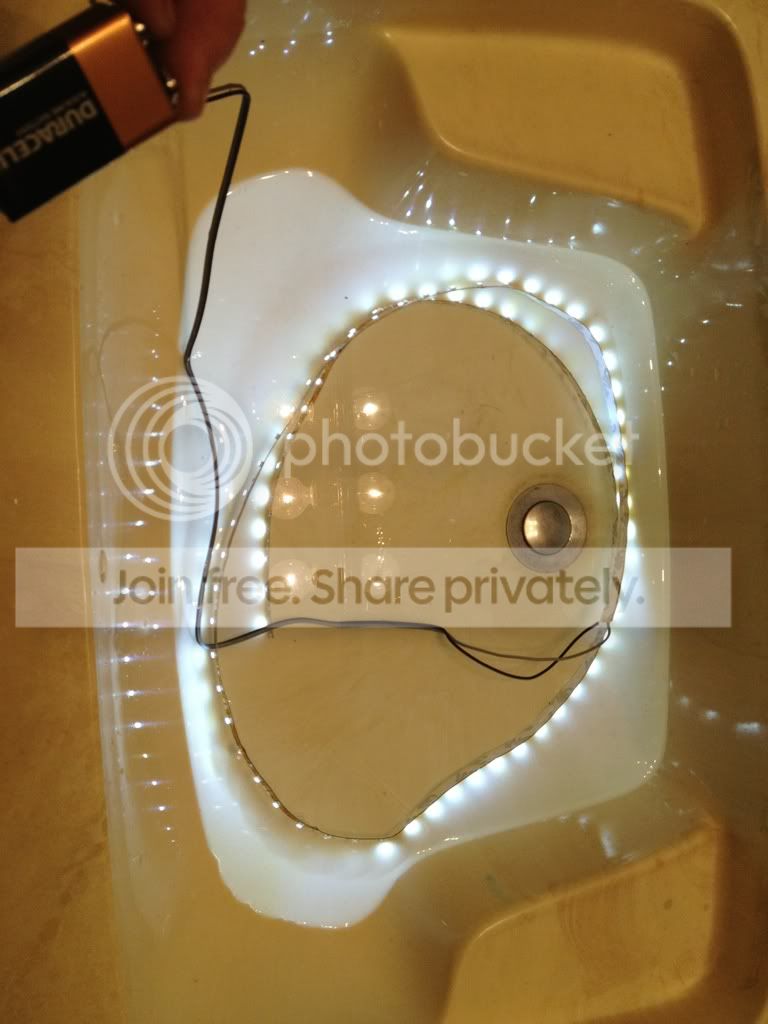

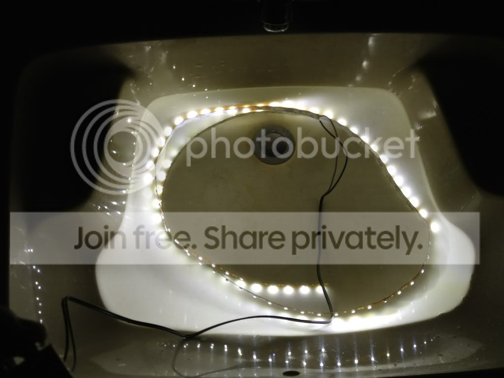

    This is the safe with the leds on, underpowered with a 9volt battery instead of 12volt. The leds are the only lights on in the room.
    Switch
    Video from inside the safe of the door closing and lights turning on and off.

    Fully finished install!!

    THey are also waterproof!

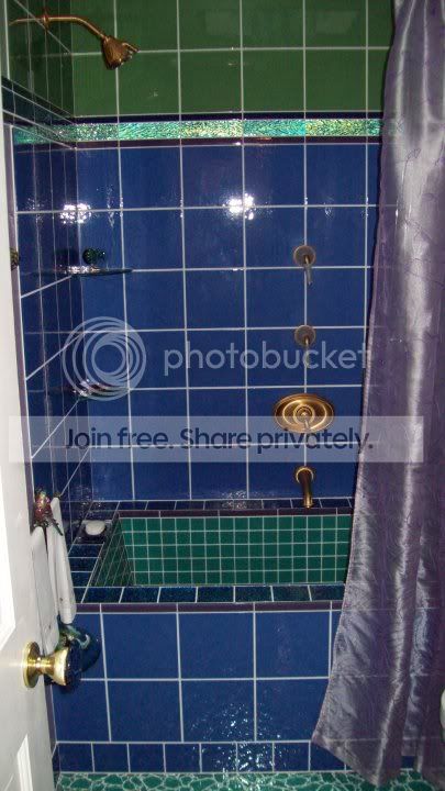

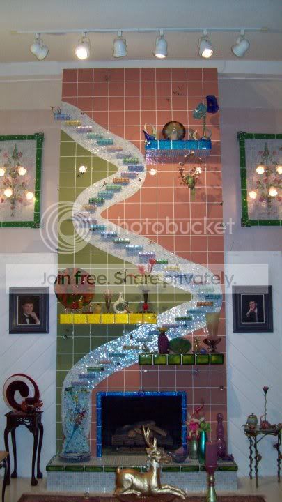

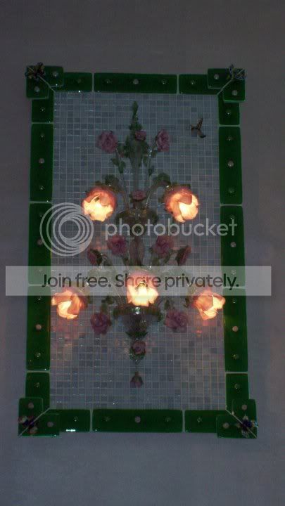

    Tried to get my brother-in-law to use LED strips on his custom tile jobs, one lady paid him over $10K for labor in her home where he made a waterfall tile wall in the living room and a glass tile custom bathroom. One of his works was featured on HGTV, "Ultimate Baths".
    Real 24K plated fixtures.
    She drew it on paper, he built it.
