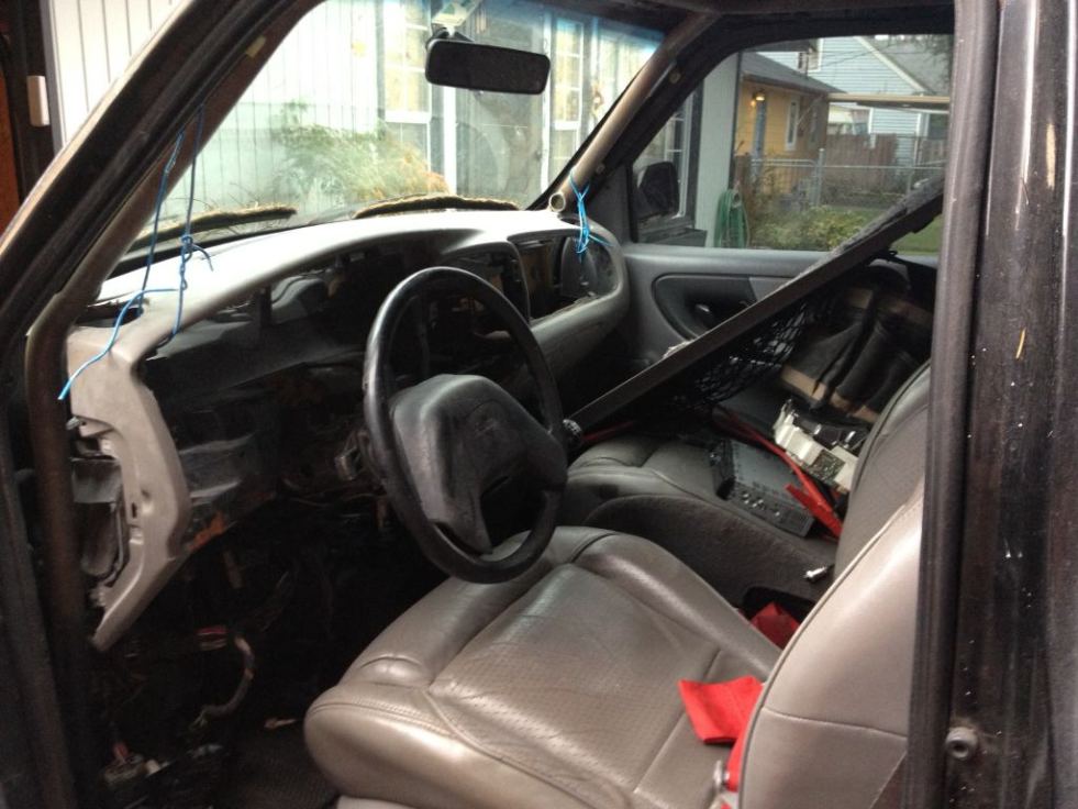

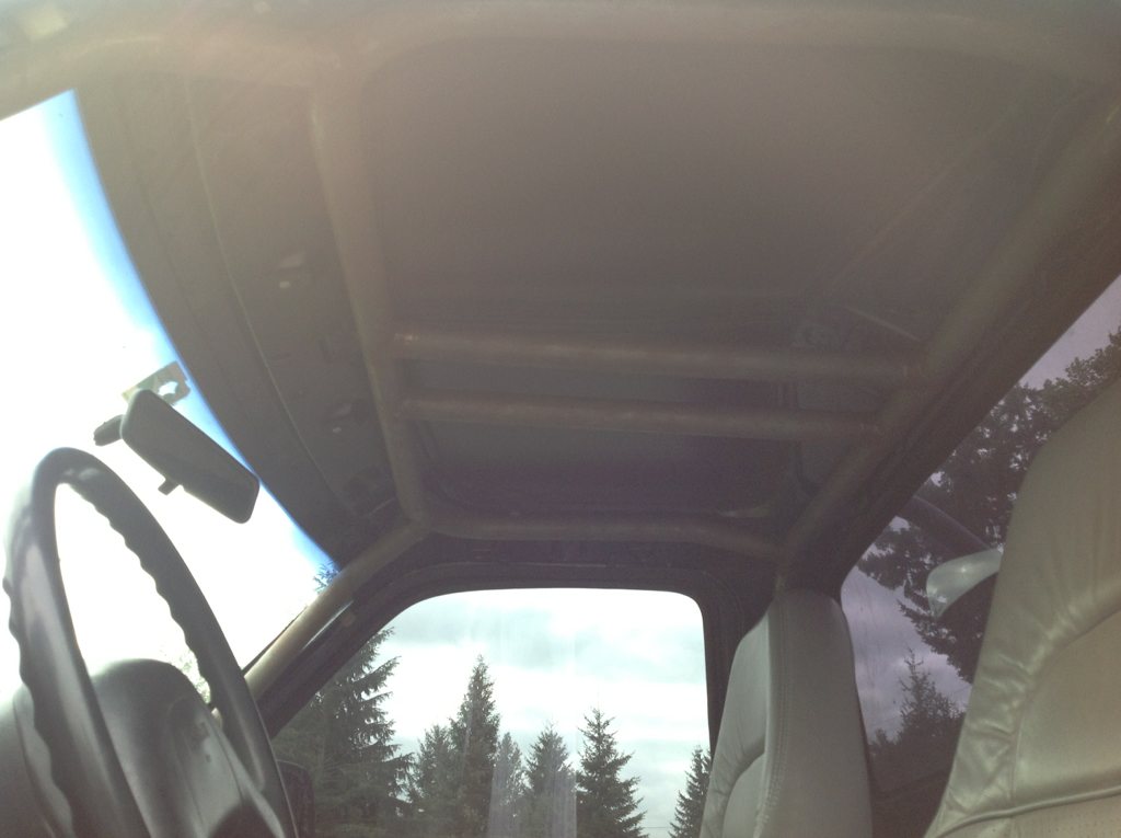

    I'm positive you all have been sitting on pins and needles waiting for this thread, I finally got a chance to get out and work on the Mazda. So for build thread sake, the specs are: 94' Mazda b3000 4x4, twin stick, 6 inch skyjacker on 35 inch wildcat ext's, gutted interior, and a roll cage through the cab and into the bed.
    When I got it:

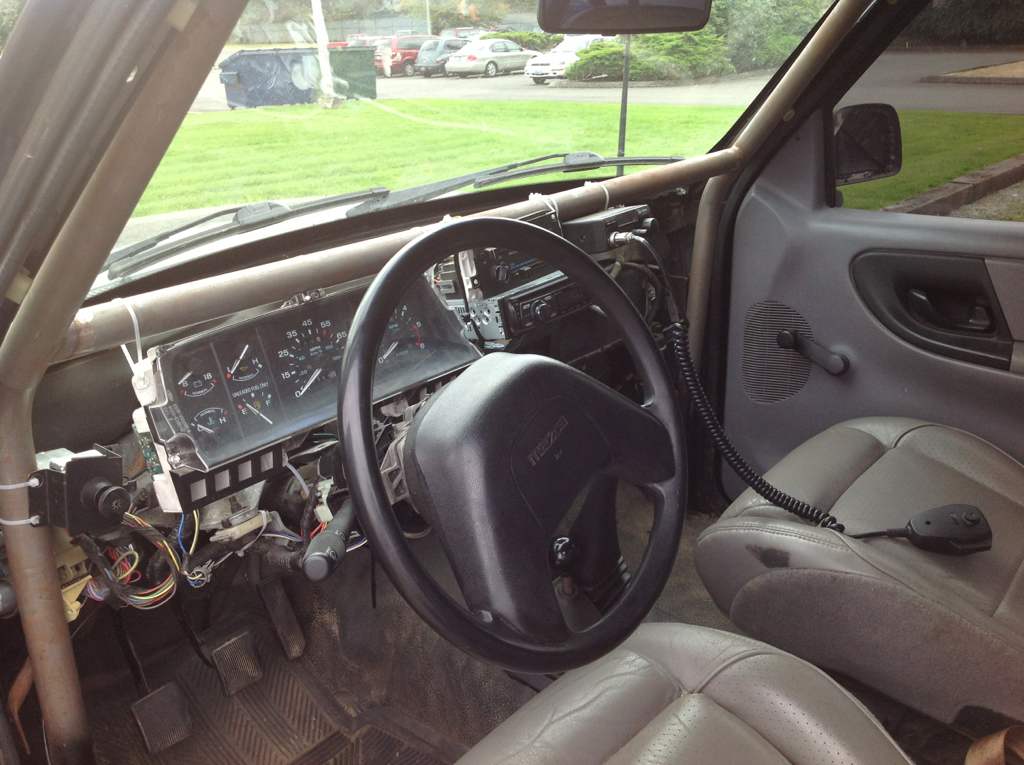

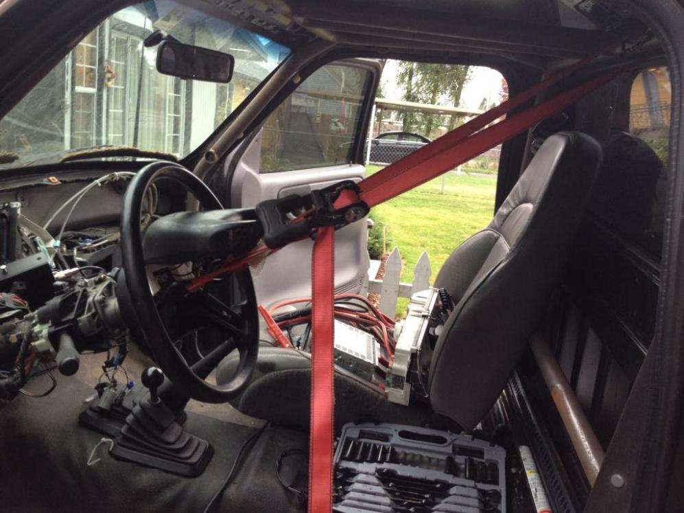

    My buddy had a parts ranger, a 98' he used to help rebuild his brother inlaws fx4 level 2 so he gave me 95% of the interior pieces including the dash and steering column. He was just going to chuck em'. I'm hoping to use the 98 steering column and wheel since I had to cut out most of the support to mine. My column support mounts to the firewall and the newer dash mounts to the dash subframe. So if the columns aren't interchangeable I can just fab a bracket for my column to fit the new dash. What I did is cut out the dash to fit the roll cage, I had to pull almost everything off the firewall and I would have pulled the column but I had to be able to get it out of the driveway and I didn't think I would have time to dry fit the column. Anyways, PICS!

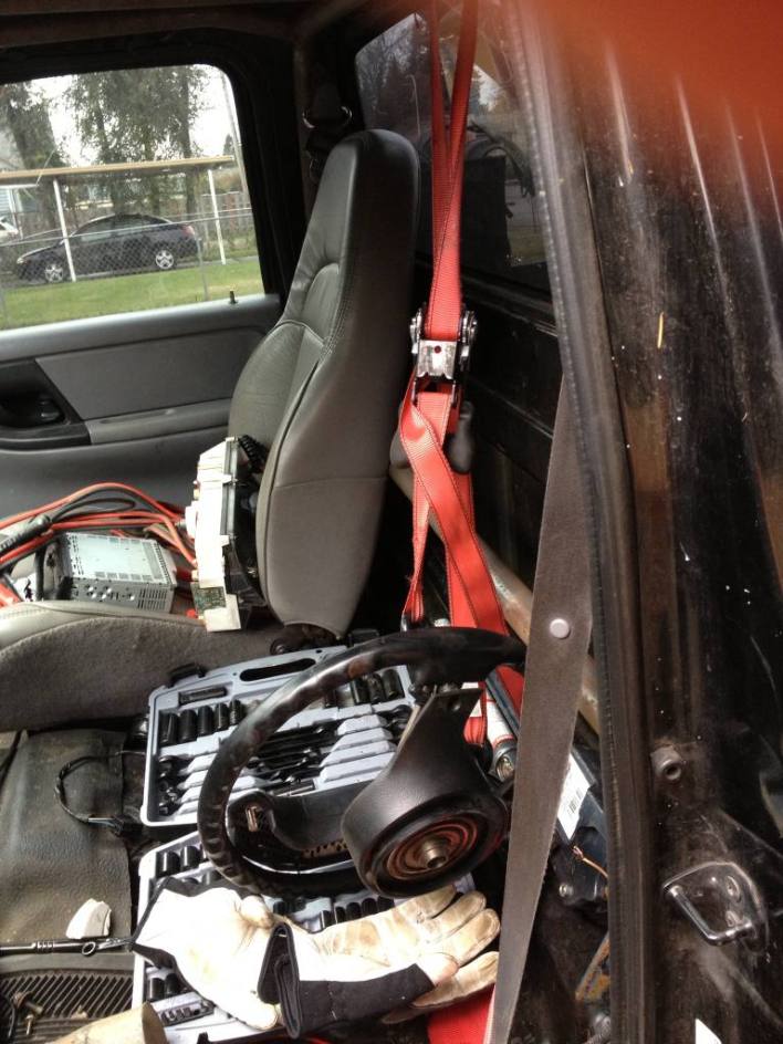

    Pulled the newer steering column.
    Who needs a steering wheel puller?!
    Dry fitted
    How it sits now, more work soon!!!
