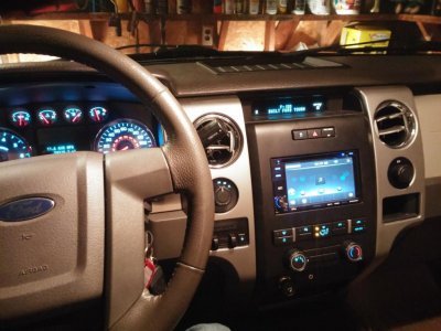

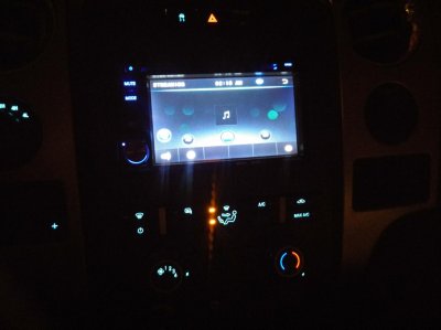

    Got off work early tonight so I decided to freeze my balls off in the garage and put my new radio in.
    Bought a Scosche double din dash install kit, Metra 70-5520 harness and a Boss double din with streaming Bluetooth, back up camera capability, plays movies, USB and SD card ports as well as a speaker port to use the radio to make phone calls. Think I paid around $200 for everything.
    For the 2010 ( might be other years too) when hooking your wires up from the new radio harness to the Metra harness you have to hook the 12V ACC wire on the radio harness to the ACC wire at your ignition switch. The pin on the Metra harness where the 12V ACC wire is, is a blank port on the factory harness. Everything else on the harness will work properly.
    All I need to buy now is a camera and apparently I need an antenna adapter.
    Would love to get some speakers and other audio components but don't know where to start.
    The only little issue I have is I wish the dash panel looked more factory. The factory panel is textured the new one is smooth.

    looks real clean!
