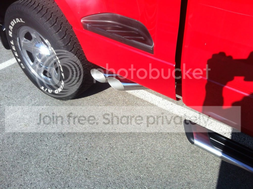

    Exhaust Exit Locations:
    Stock
    Harley Style (Dual tips, stock location)
    Dual Rear
    Lightning Style
    Cowboy Style (Dual Rear, but usually angled 45*)

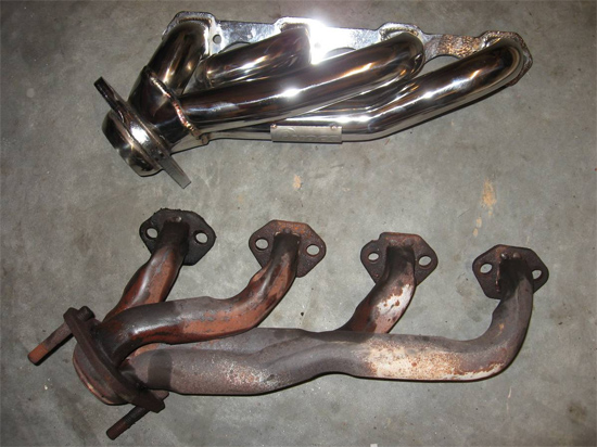

    Headers
    You can buy long-tube or short-tube headers. Short tube are a direct replacement for the stock manifolds and flow a little better, but not enough to make them worth the time and money.
    Long-tubes are more expensive but give you more torque and a little more horsepower. Any shop capable of installing the headers should be able to connect them to whatever exhaust you have.
    Shortys vs stock manifold
