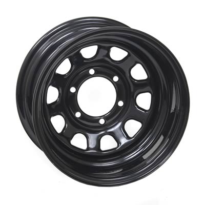

    first one:
    Pro Comp Wheels
    Xtreme Rock Crawler Series 52
    Black
    Wheel Diameter 16 in.
    Wheel Width (in) 10.000 in.
    Wheel Material Steel
    Primary Wheel Color Black
    Wheel Finish Gloss
    Backspacing (in) 4.000 in.
    Offset -38.00mm
    Wheel Construction 2-piece
    Beadlock Functional No
    Beadlock Included No
    Lug Nut Seat Style Conical seat - 60 degree
    Hub Centric No
    Center Cap Included No
    Load Rating (lbs) 2,000 lbs.
    Valve Stems Included No
    Quantity Sold individually.
    Wheel Bolt Pattern 5 x 135mm
    Pro Comp Wheels 52-6153 - Pro Comp Xtreme Rock Crawler Series 52 Black Wheels - Overview - SummitRacing.com

  7. FFDanF91
    FFDanF91 Junior Member
    16
    Sep 15, 2012
    Florida
    Hey im ordering these. Think they will fit with 6 in lift and 315/75/16
    Wheel specs:
    •Backspacing (in):4.000 in.
    •Beadlock Functional:No
    •Beadlock Included:No
    •Center Cap Included:No
    •Hub Centric:No
    •Lug Nut Seat Style:Conical seat - 60 degree
    •Manufacturers Wheel Series:pro Comp Xtreme Rock Crawler 152 Series
    •Offset:-38.00mm
    •Primary Wheel Color:Black
    •Quantity:Set of 4
    •Valve Stems Included:No
    •Wheel Construction:2-piece
    •Wheel Diameter:16 in.
    •Wheel Finish:Gloss
    •Wheel Material:Steel
    •Wheel Width (in):10.000 in.
  8. DestinationFX4
    DestinationFX4 Admanistrator
    4,798
    Feb 8, 2011
    College Station, TX
    Whats your backspacing requirements of your lift?
    What lift are you running?
  9. FFDanF91
    16
    Sep 15, 2012
    Florida
    I bought the truck with a lift its a trail master lift(I know its odd). so I have no idea.
  10. DestinationFX4
    4,798
    Feb 8, 2011
    College Station, TX
    according to their website, it says that you can use the factory wheels and tires with the lift kit. If thats true, I would use wheels with factory specs (5.5" backspacing IIRC) to insure a proper fit.
