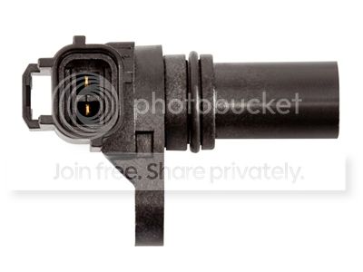

  3. Stangshcky12
    1,360
    Aug 8, 2012
    PA
    What are your local temperatures like?
    Can you hear the glow plug relay click?
  4. BadInfluences
    BadInfluences Junior Member
    3
    Sep 10, 2014
    Not checked the cps, but glow plug relay clicks. It was about 30°F when it failed to start.
