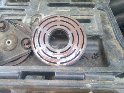

    Clutch blew up haha. Trying get the last piece off of the compressor and then hopefully I can turn the shaft. I'll let ya know.

    I see the ball bearings.
    Maybe you'll get out with just the clutch.
    Pity7700 likes this.

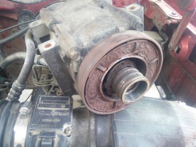

  3. Pity7700
    I'm able to move the compressor but it has resistance, actually had to put that front triangular plate back on the shaft and tap it with a hammer a couple times to free it up, it turns but it gets really stiff at one point.
    Normal??
  4. Pity7700
    Looks like my compressor is a no-go.
  5. Roush PSD Interceptor
    58
    Maybe that's what burnt up the clutch.
  6. Pity7700
    Something, looks like I need a whole new compressor.
