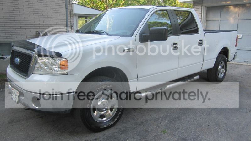

    I just a new to me 2007 F150 4 Door 5.4 Triton 4x4.
    My tires say 44 PSI. The truck sticker says 35 PSI inflation pressure.
    My Dash board Tire inflation warning light is always on for some reason. I have disonnected the battery to try and reset it. Not sure how to get it to shut off. I have not tried deflating my tires to 35 PSI yet. Not sure if that would be recommended for tires that are rated for 44 PSI.
    Anyone with any experience with this snag?
