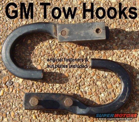

my dads mini has em like ^^. Id recomend getting some GM tow hooks: as you can see theyre bolted from the inside of the frame rail and not the bottom ur lowered truck is 2wd so you may or may not have holes in on the frame to bolt em on so ud need to drill em. I did and moved them a little bit more fowards than what the 4x4s came with. I recomend going this route so then you know theyre solid. also you could use ur 2wd valance and cut a little slit in it for the tow hook, or if you dont want it to show mount them farther back and put on a shackle that can be added or removed, however youd need to remove the valance....OR get a 4x4 valance and cut little slit to extend the tow hook slot up so you can have the hook sticking our an inch or two, then put some lo profile lights in there so it doesnt look like theyre open holes where hook are supose to be... just some ideas for ya
