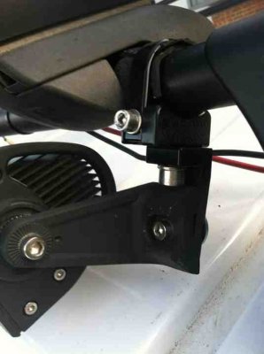

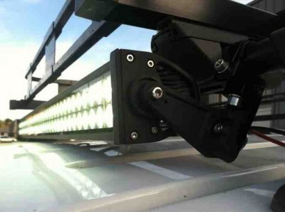

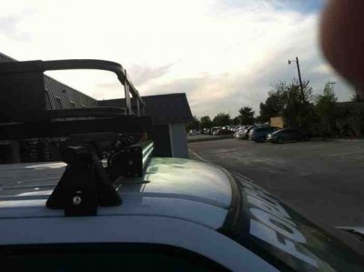

    you can't bend the pipe mounts to match the pipe?

    Nah, ull see
    And boom goes the dynamite.
  3. 01f1502wd

    the bracket, once tight (should be a 1.25" pipe) it would be tight. but with a small pipe its loose. its a solid mount and doesnt contort much.

    You need a spacer pipe between the pipe and bracket like a sleeve and tack weld it to tje pipe
  7. ak_cowboy
    Get some 1/2" thick rubber strips
  8. 01f1502wd
    ^ thats what i did, found an old tire on the side of the road and used stripes from the inside of it.

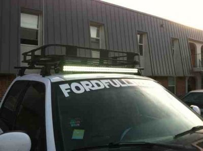

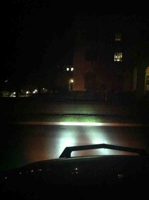

    My LEDS:
    Parking lights
    Fogs
    Big boy bar on roof
    4 hella 700s behind grill
    Im also parked on a slope which doesnt help
