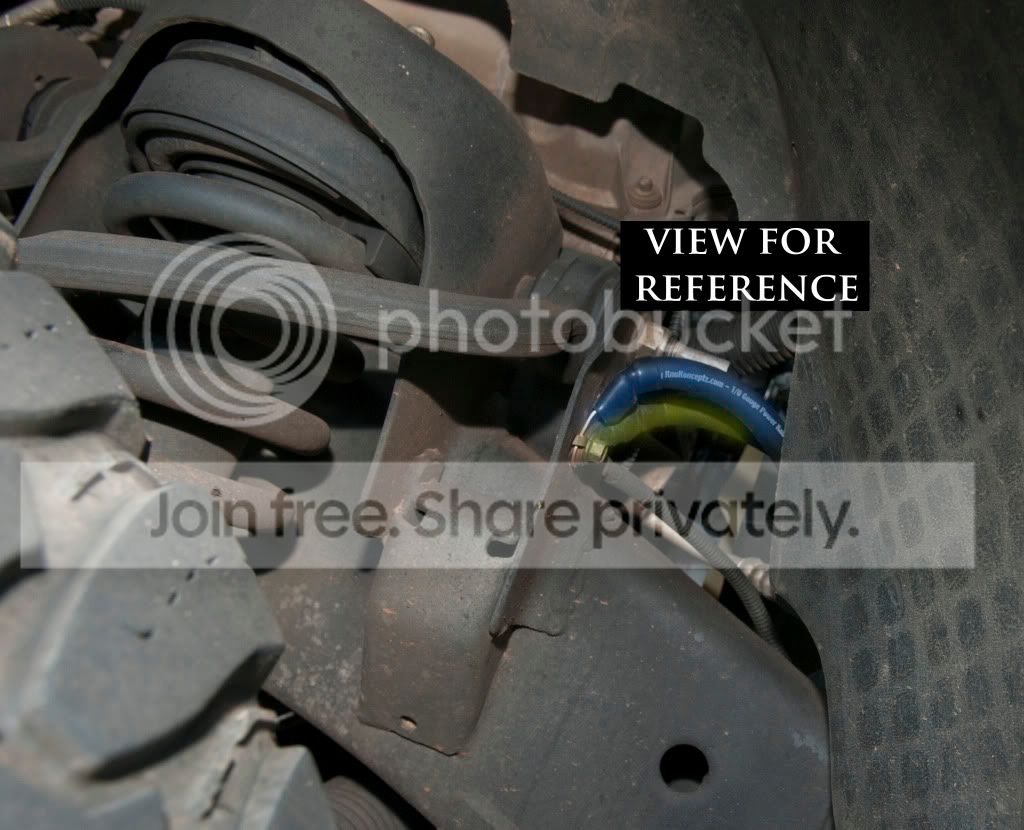

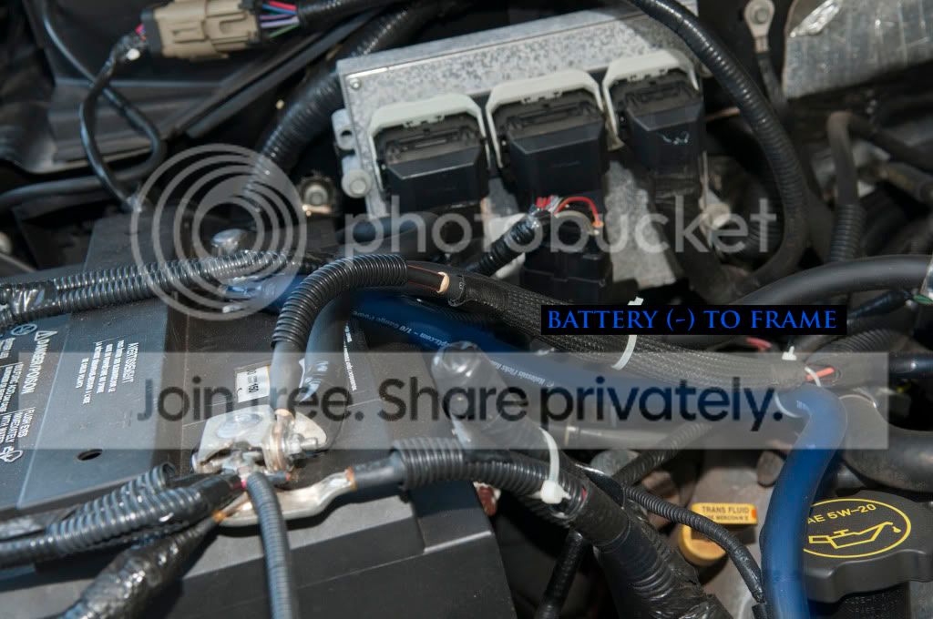

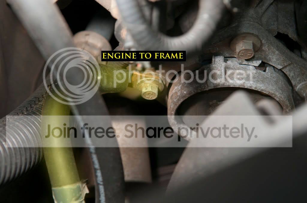

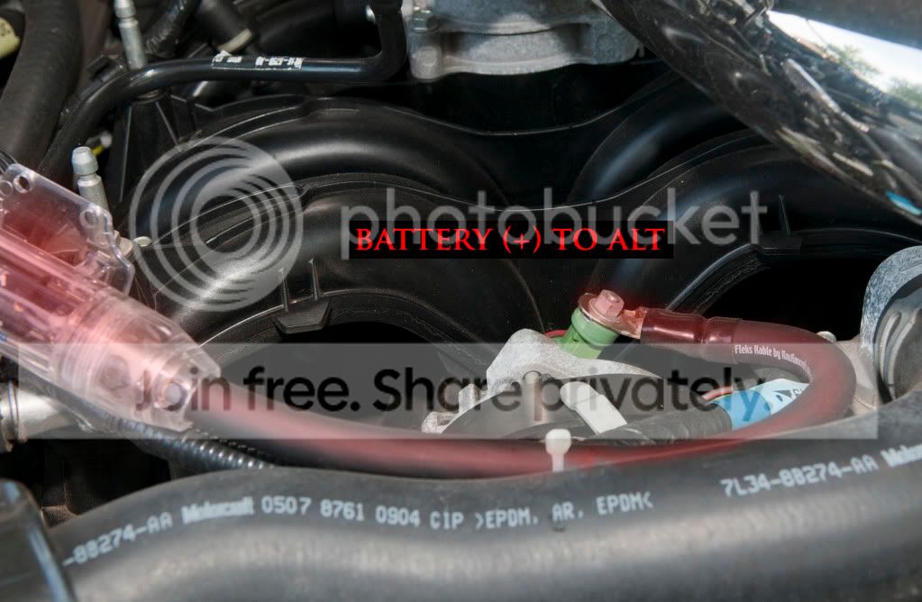

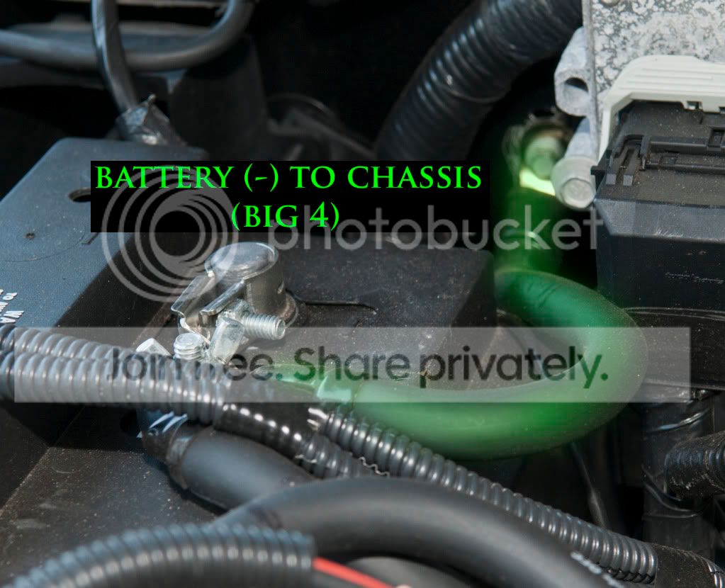

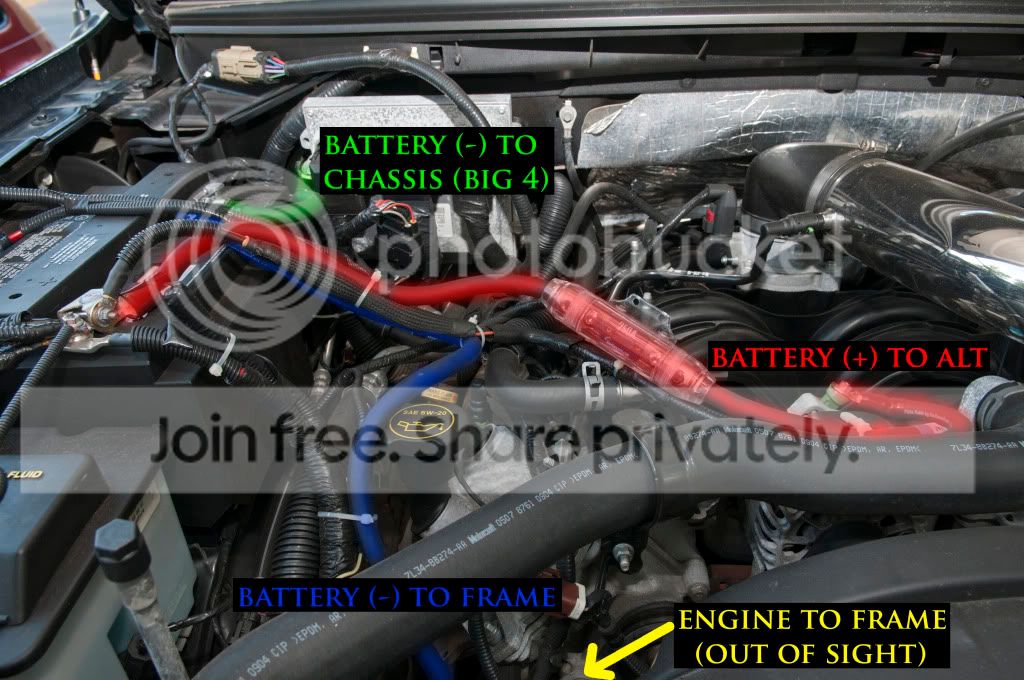

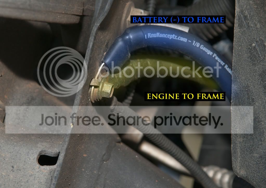

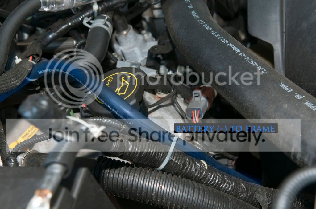

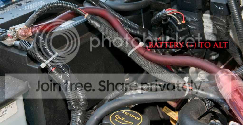

  7. 01f1502wd
    wait found them. just so anyone lookin to do it heres the pics
  8. cowboy
    ^ yep good stuff. Its on my wish list before I do all the electrical along with a dual battery setup.
