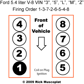

    x2. Clean the MAF and throttle body. Change the plug and COP on cylinder 2 (it's easy to reach)
    You can also just change the COP from #1 to #2 and see if the misfire follows. That would prove that its the COP and not something else.
