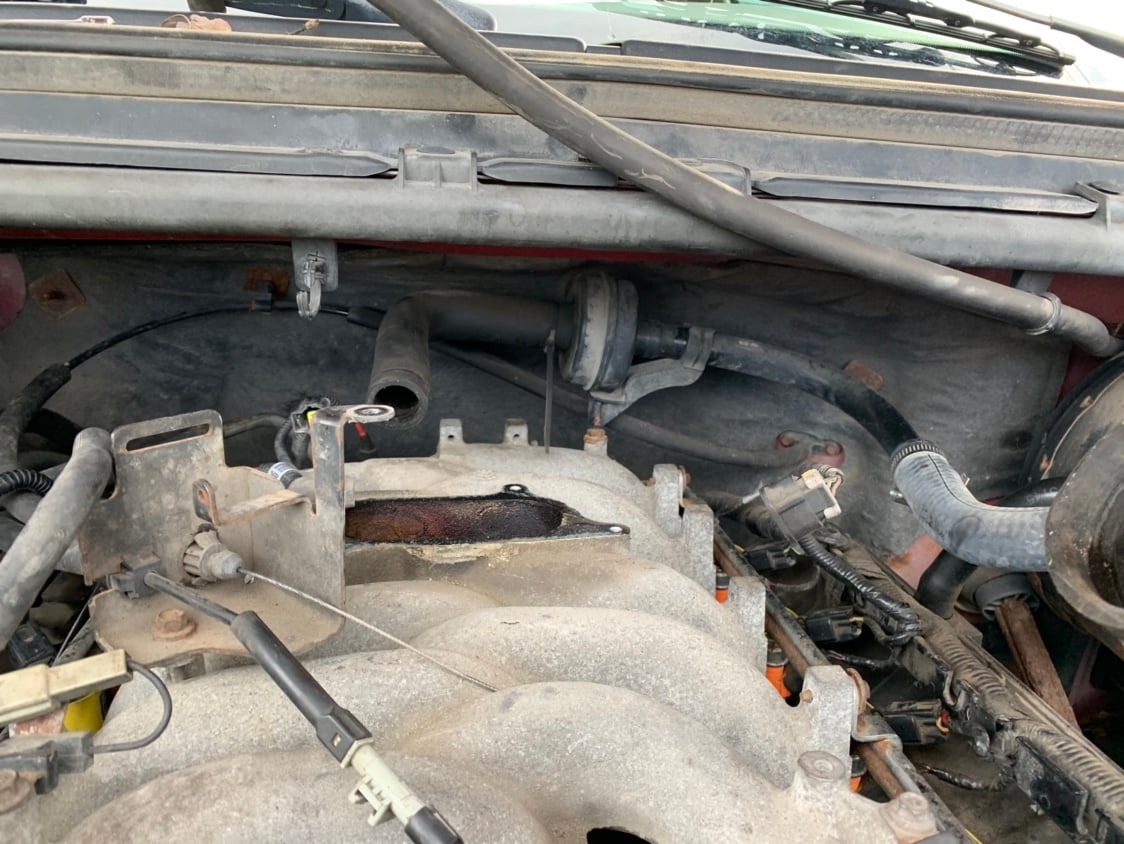

    Truck was idling like crap. Had P0171 and P0174 DTCs. Doing TLC.. Pulled Throttle Body, IAC, found bad hose to replace, want to clean EGR and valve cover gaskets while at it but can’t find the EGR.

    I replied to this the other day. Thank you Roush PSD for trying t to help. And yes Sir, I totally agree that it should be there with some kind of exhaust line run it. I went over that motor with with a fine tooth comb. I generally can find and identify one 3 out 5 times. This seriously had me second guessing myself.
    At first I thought it might have been this: That canister looking thing up against the firewall, with the hose on ether side, but didn’t look like any EGR I’d ever seen.

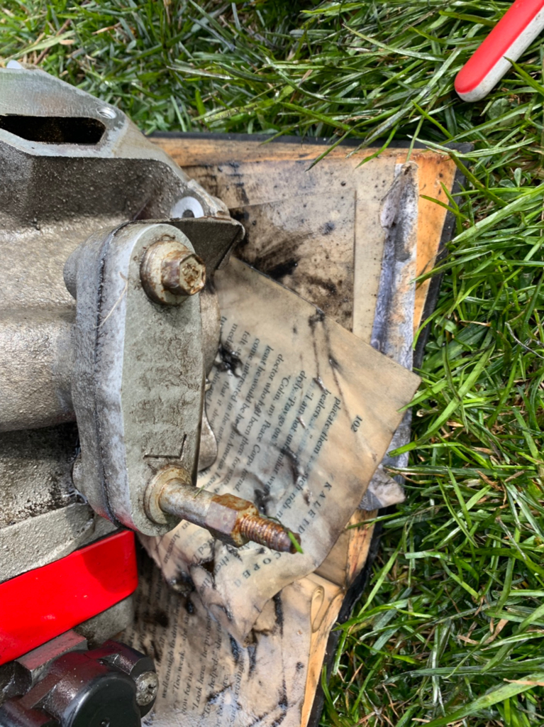

    As I’d mentioned earlier, I needed a new PCV elbow hose. I went to the dealer looking one. Advance wanted $27 with a weeks wait. I carried that plenum in with me. I asked that EGR question to them. The guy says “You ain’t got one”. Now I’m really confused, he walks back up and I’m 20 questions. So....ends up that mine had been deleted.
    T[​IMG]

    Not a bother Jeff.
    Definitely deleted.
