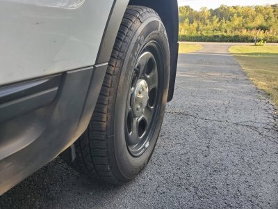

    Set the ride height to 19 3/4" same as before disassembly using a pump jack
    on the lower steel swing arm. Loosely mount top swing arm to knuckle with bolt/nut.
    Loosely mount lower shock bolt. Push inward on top of rotor for total negative camber
    then tighten top swing arm to knuckle mount to 148 ft. lbs.. Tighten lower swing arm to knuckle bolt/nut to 195 ft. lbs.
    Tighten lower shock mount bolt to 129 ft. lbs. Tighten toe link bolt nut to knuckle to 59 ft. lbs.

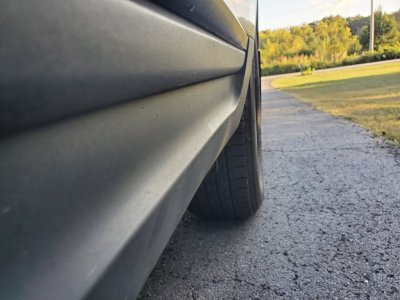

    It has been 300+ miles since the repair and no leaks from the differential.
    You can see in the first pic the zero negative camber preset as defined by the
    assembly manual instructions.

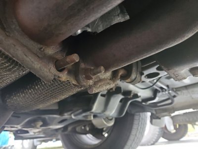

    After going around in circles with Ford of Dalton on fixing the F'ups Tech A86 created during Recall 19E02,
    the recently discovered missing retainers in the wiper cowl plastic to top of firewall
    (why in the world were they in there?)
    and missing nut on the exhaust stud after the twin flex pipes causing a leak,
    I decided to never take it back there again.
