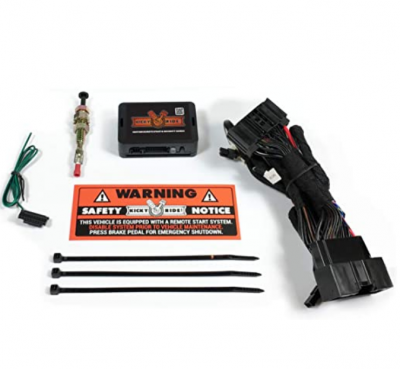

    Does anyone know if the remote start plug n play kit from 2011-2014 f150s will work on a 2021?
    I get that the fobs are diffent styles, so I would need the switchblade key with a 2x button.
    I was able to add oem remote start to my 2014 edge by adding the tpms anteena, programing a key with a 2x button, and enabling in forscan.
    My brother has spotty cell coverage so using Ford pass is intermittently successful.
    Thoughts?

  2. Roush PSD Interceptor
    59
    @thesavo
    Welcome to FFS
    See this one on the 'Jungle'
    https://www.amazon.com/KICKY-RIDE-C...fdcac&pd_rd_wg=qU5Fr&pd_rd_i=B07GH7CDMM&psc=1
    FORScan, great tool.
    Bought OBDLink MX - bluetooth, came with TORQ
    app.
    Laptop is my way to get in, so much easier.
    All I had to do on wife's 2013 Explorer PIU was
    add hood pin and Edit 2 lines of the codes,
    program two 5 button fobs I bought on fleabay.
    Not sure what is available for the 2021 F-150.
    Check the FORScan Forums though.

  5. Roush PSD Interceptor
    59
    The pic on 'Jungle' tap in cable for harness in steering column
    and brain box.
