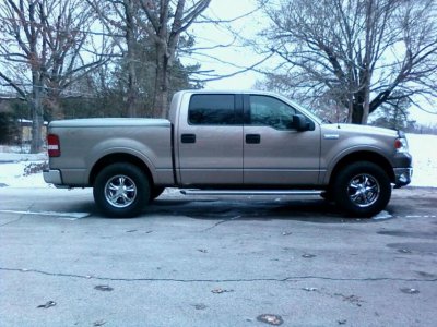

I'm looking to get 33 inch tires on my 2004 (stock height) and i was wondering if there was anything speacial i have to do to the truck just to fit them under the truck
level it 2.5 inches. dont get the urethane ones, they compress after a while. get aluminum
I forgot to add i have 2 inch drop shackles in the back it shouldnt really effect anything should it? seein how there is still a good bit of fender clearance
Back's gonna be fine, but I'd take those drop shackles off. You'll be riding Cali if not. :crazy:
put stock shackles back on and put a 2.5" Rough Country $99 levelin kit on it and itll be dope , thats what my dad used to run
Take drop shackels out...put the 2.5 in and you'll be good to go:waytogo:
