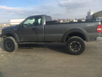

    Hi here's the 37's

    I took a pic of the little rubber at the bottom it will run on sharp turns. I was going to trim that.
  10. ak_cowboy
    That fits better than I thought it would. You can swap a 9.75 axle in the back from any other F150 and lose the week 8.8
