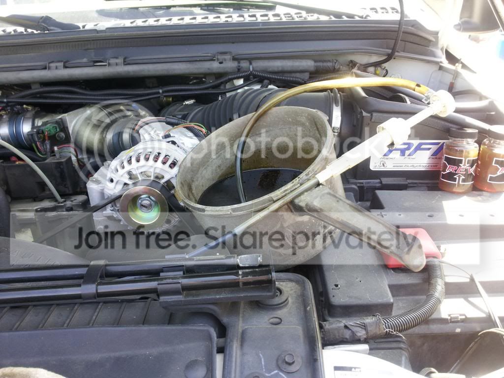

So I have been using a quart lube pump to drain my HPOP
at every oil change.
Today I put two bottles of REV-X in after the second cycle of HPOP
flush and fill.
I can tell a great difference in the idle of the 7.3 now. Much smoother
and quiet, not nearly as much unbalanced feeling during idle.

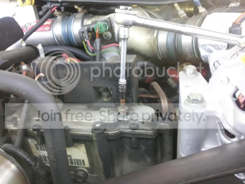

Plug in top of the HPOP.
Lost my Viton extension tubing, I'm using 1/4" OD ice maker tubing to make an extension tube to reach
the bottom of the HPOP oil reservoir.

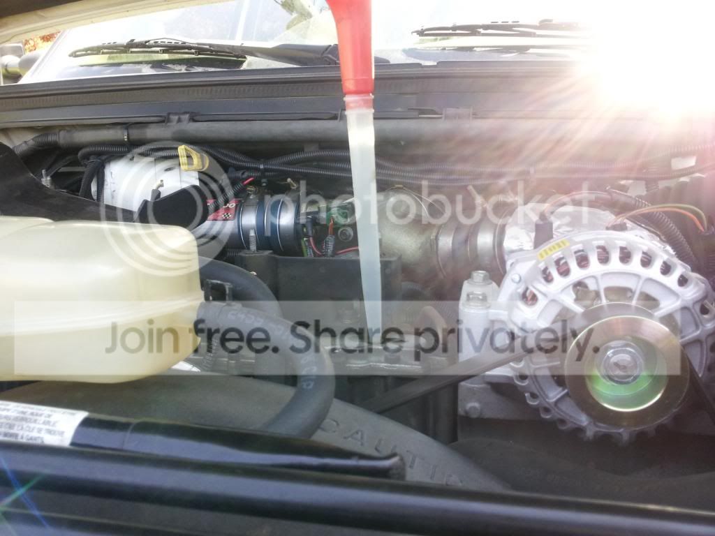

Made a funnel out of a turkey baster to fill the HPOP back up.
Replace the fill plug and run the motor 5 minutes, then drain
and fill cycle twice more. Oil doesn't get dirty until 7K miles now.
