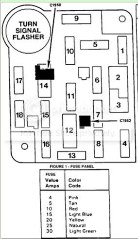

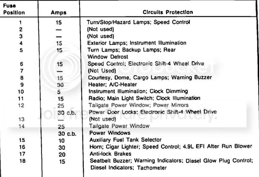

  4. Roush PSD Interceptor
    Hope this is the right one.
  5. jake wells
    jake wells Full Access Member
    113
    Mar 17, 2013
    park city kentucky
    thanks i appreciate it.
  6. jake wells
    113
    Mar 17, 2013
    park city kentucky
    i pulled the clock/radio fuse and now it stopped pulling power so i guess i might drop a cd player in it and add some cheap speakers in the door.
