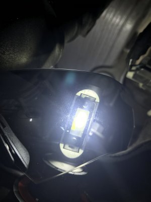

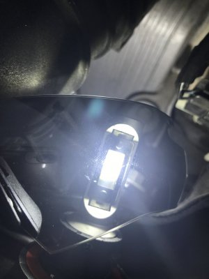

  5. Jeff6146
    Jeff6146 Junior Member
    8
    Sep 19, 2018
    Killeen Texas
    E120EEA4-DE00-4044-B304-0512D56ACDE3.jpeg B2A160C5-E3FD-413C-BD78-F36DEE1867F7.jpeg B2A160C5-E3FD-413C-BD78-F36DEE1867F7.jpeg
  6. Jeff6146
    8
    Sep 19, 2018
    Killeen Texas
    I got it off amazon, put in all my vehicles info and everything. called the company and they've sent replacements 3 times. all 3 times same thing

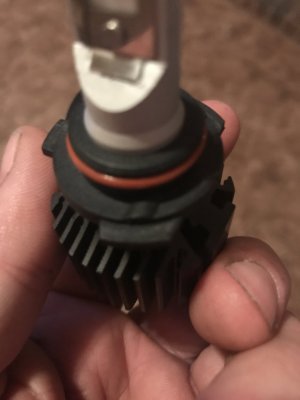

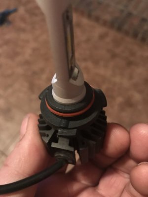

    Thank you so much for your help. So these are only single light bulbs? They have two sets of leds, which means they have a high and low. Is that right? I’ve not seen leds with two sets that weren’t a high and a low. What are your thoughts. A6298768-CE2A-48B1-A9E7-9AA9C4341AC5.jpeg 5DDB9457-7CCE-426D-AA4C-EA63D775DC29.jpeg 60FA3D65-4AD3-4E43-A679-323FE6EB48B5.jpeg EA529968-D488-43EC-A170-DFC7D5EA7242.jpeg 913D3C8D-CBA0-44A8-8999-8A23BF5C7EC6.jpeg A6298768-CE2A-48B1-A9E7-9AA9C4341AC5.jpeg 5DDB9457-7CCE-426D-AA4C-EA63D775DC29.jpeg 60FA3D65-4AD3-4E43-A679-323FE6EB48B5.jpeg EA529968-D488-43EC-A170-DFC7D5EA7242.jpeg 913D3C8D-CBA0-44A8-8999-8A23BF5C7EC6.jpeg A6298768-CE2A-48B1-A9E7-9AA9C4341AC5.jpeg 5DDB9457-7CCE-426D-AA4C-EA63D775DC29.jpeg 60FA3D65-4AD3-4E43-A679-323FE6EB48B5.jpeg EA529968-D488-43EC-A170-DFC7D5EA7242.jpeg 913D3C8D-CBA0-44A8-8999-8A23BF5C7EC6.jpeg A6298768-CE2A-48B1-A9E7-9AA9C4341AC5.jpeg A6298768-CE2A-48B1-A9E7-9AA9C4341AC5.jpeg 5DDB9457-7CCE-426D-AA4C-EA63D775DC29.jpeg 5DDB9457-7CCE-426D-AA4C-EA63D775DC29.jpeg

    If they are wired for 9006/HB4, even if they have
    two rows of leds, then they are low beam only.
    This is the mistake the sales team @ sealight has made.
    They "see" two rows of led an assume, high and low beam operation.
    If you look at the pin in on the 9006 bulb it should look like this.
    Two pins.

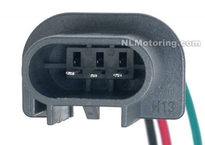

    On a H13/9008 bulb there will be three pins to match the three
    female terminals or vice versa of the end of your factory headlight wiring.
    One is ground, second one is low beam and third pin is high beam.
