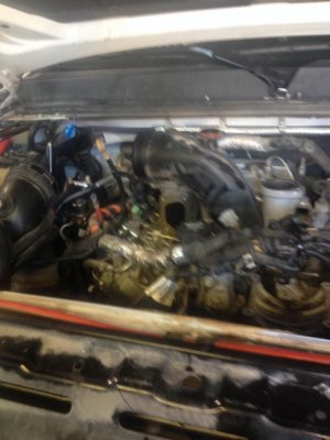

    now im a die hard ford fan and owner but i do work for gm haha just curious if any one has run into the inj pumps failing at 50,000 miles on the 2012 duramax cause tomorrow i will start on one. gm say to replace and clean the entire fuel system this job pays 30hrs :Grenade: ill take pics on what i go through

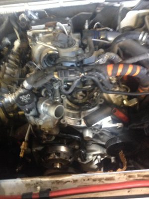

    day 1 is over what a nightmare here are the pics

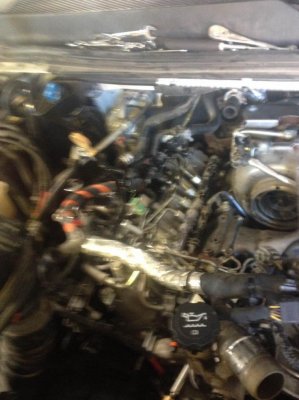

    this was after i had removed most of the front of the motor

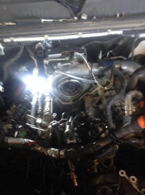

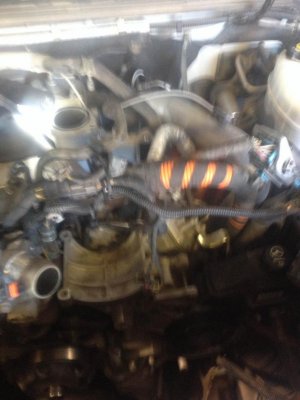

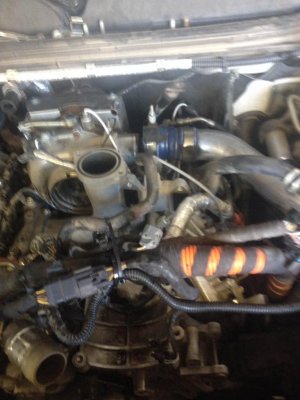

    here some more carnage

    gm has not told us what is causing this but, from what i can see the diesel fuel was very dirty this is the second truck ive seen where the inj pump was damaged but they used farm diesel the guy put a wix filter on it and then said 3 day later it wouldn't start. but tmr its all going back together got a truck full of parts :happy160:
