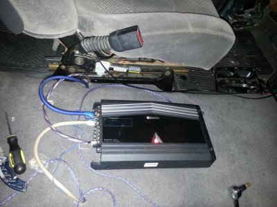

    Well guys, I'm officially bumpin haha
    Subs are all wired up and they are doing their job. They don't shake the house down but plenty enough for my liking lol
    I go back to work tonight so ill be doing all the speakers next week. Hopefully it'll get me really crisp sound all together. Here's where the amp is I had my passenger seat out today. Wires are cleaned up more than whats in the pic. You can see where the two cuts in the carpet are on either side where I ran the wire up through.
