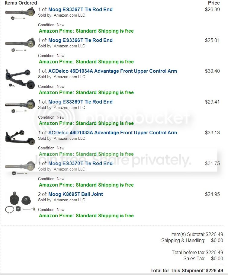

I just did this a couple weeks ago, lucky for you I already did all the cross referencing and this is the best group of parts for the money you can buy. Instead of just replacing upper ball joints, do the whole upper control arm, wayyy easier and also has new everything including the bushings. youll need TWO like 22 or 21 mm sockets or wrenches to undo the bolts. For lower ball joints youll need a ball joint press ( oreillys loans thems for free, you put a deposit and get it back once its returned. youll need snap ring pliers or just use a stright blade screw driver to pry off the snap ring ( either works) and then the ball joint press. Tie rods are self explanatory , Measure the previous tie rod length and count the threads and get the new setup as close as you can. Any questions lemme know or post on here, lots have done this and I believe Josh made a thread on it also If they dont have a fork you can rent or if you dont own one, the ball joint press I rented I used to pop all the joints, It had big enough cups and was super easy to do.
