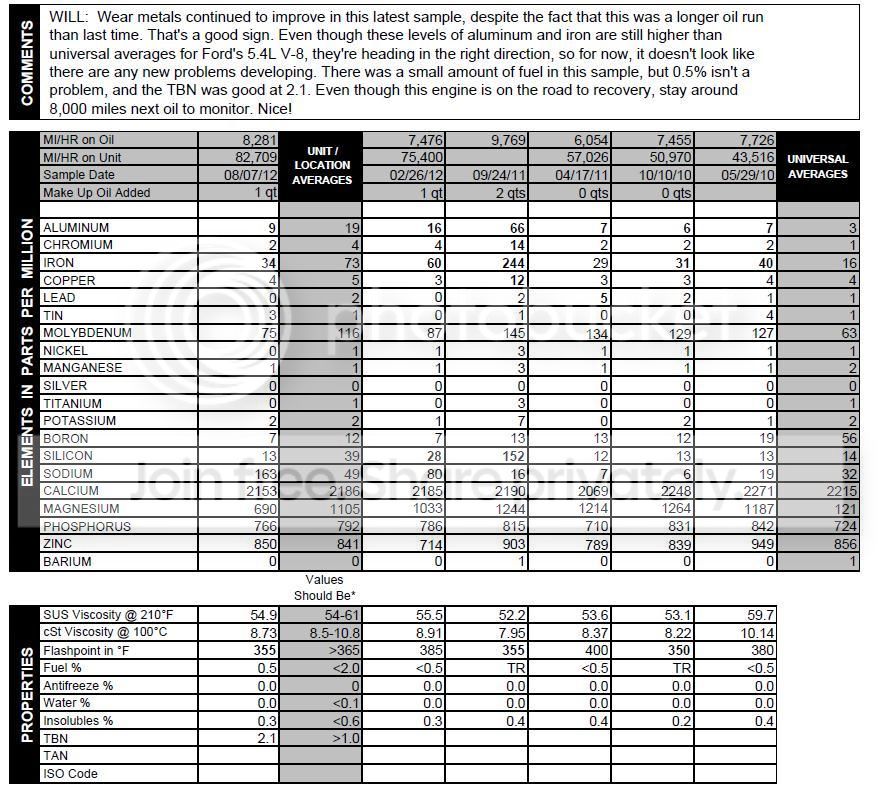

Here is my latest oil report from Blackstone Labs.
7500mi change intervals with 5w-20 Royal Purple and K&N Filter.
I think the high amounts of Al and Fe are due to excessive cold starts during the winter and longer idling times.
Latest update on my oil analysis by Blackstone. 8281mi this time around.

And why do you get this done;
sent from my F-350
It's so I can extend my oil changes and for peace of mind. Most dealers try to get you to change at 3000mi, maybe 5000 with full synthetic. Getting this test done is allowing me to go to 8000mi. Saves me time and money in the long run.
The universal average is all the reports they have done on Ford 5.4 3v V8s. But they also stress that those are only guidelines and that each engine is different, which is why it's important to have several tests done so you can establish a baseline for your individual truck.
