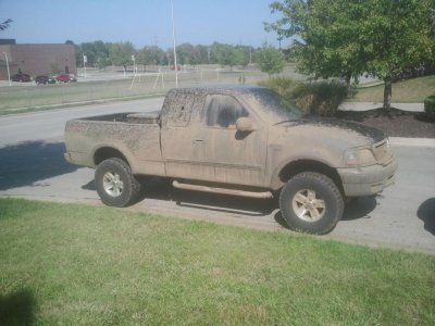

    I went mudding a few days ago and on the way back i had to pull over because it was getting too hot. I slowed down on a back road off of the highway to see if it would cool itself off. Well as i kept driving slow all of a sudden the temp gauge shot up to the red, and i immediately shut it off. I popped the hood and got out to look at it and my coolant was flowing out the top of the overflow tank. There was a small amount of smoke/steam on the drivers side. (Coolant hadnt been changed before me so it was brown and thick and looked like paint, it was on the list of things to do )

    This is the aftermath :peace:
