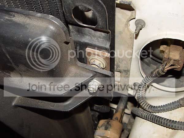

Hey i am currently in the process of finally installing my 3 inch body lift that i bought used. It came with front and rear bumper brackets only. So the parts that i think i am missing are the transmission bracket (for my automatic), and my radiatior shroud bracket. I have figured out how i am gonna change the tranny bracket but i need dimensions on the radiator brackets. Pictures would also be helpful so i can see how these parts mount. Thank you guys!

take a pic of what you have and post it..we'll get our collective brains together and go from there
Heres some pics... its just basically a peice of flat aluminum with a bolt threw it at the bottom and a hole in the top , you use your stock bolt threw the whole in the top and bolt it in the stock location ..... then put the shroud on the bolt in the bottom of the bracket.... thats pretty much all there is to it.... just make sure your 3" from the center of the hole you drill in your bracket to the center of the bolt you put in your bracket
Yup thats it....forgot you had them pics on tap....
Thank you bigun72 thats exactly what i needed to know. You and Westtnfx4 are the reason that i joined this site.
