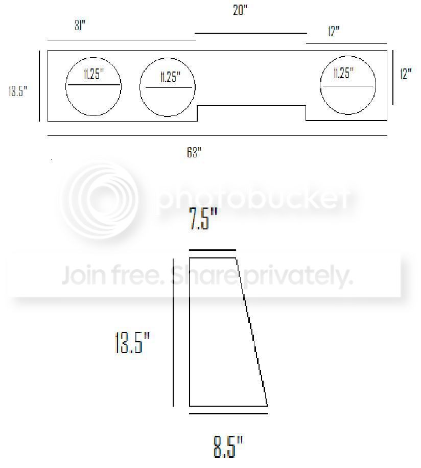

    alright so im gonna be building a box to go behind my rear seats because im tires of the low air space from my tired out p3's
    gonna be using Kenwood Excelon KFC-XW1200F
    anyone have any usage of fiberglass for a box

    heres what the box demensions are gonna be

    U sure u can get a box back there that big

    Thats going to be around 2.5 cubes?? minus the volume the subs take up..
    You think thatll be big enough for 3 12s??

    nevermind I just looked at the subs.. They say .8 cubes each

    yeah thats plenty big enough for cvrs, i love those subs i had 2 for a good couple years best kickers. hell best subs i have ever had

    Dood 2.5 cubes in these trucks is unheard of, u sure those measures are right?

    ya it will take a little trimming of the plastic on the sides but yes it will fit, and its acctualy 2.36
