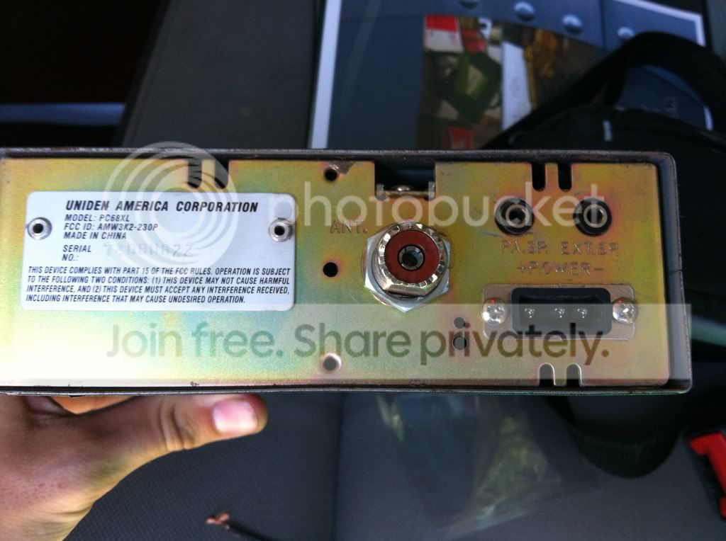

    I recently got a free uniden pc68xl CB for free and i need to know how to hook it up. my cobra 19 has the power and ground wires already coming out of the CB but this one didn't come with a power cord. It's a 3 prong power plug(below) and i dont know which one is which power ,ground , ???. what's the 3rd prong for? I could order the power plug but dont feel like waiting 4 days for it to get here so i figured i'd try to hard wire it. any ideas??

    You can buy a harness for that. I bought mine at a little electronics store in Victoria.

    You could try testing with a multimeter too

    the prong on the left when looking at the back of it is +12V from your battery the Right prong is ground. The center prong is your + trigger wire like for your radio so that it only powers when your ignition is on.

    where would i hook up the center prong to? i planned on running the power into a fuse inside so i won't need the glass fuse.
