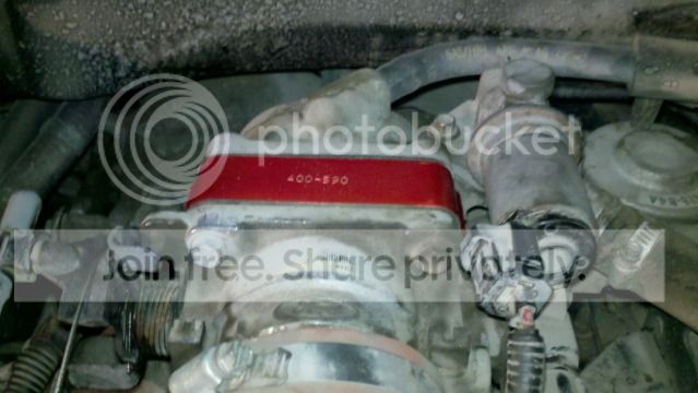

    The MAFS before removal.
    EDIT: Apparently you need those stupid ****ing safety Torx to remove this, so this won't be getting cleaned until I pick some up tomorrow. Damnit I hate saftey Torx! Most useless annoying things ever.
    IAC before removal.
    Yea I know, my engine bay is way too dirty.

    Forgot to mention that my CEL shut itself off earlier today, dunno why. Got the IAC cleaned up though and cleared the codes, went for a spin and all is good. I still have the P1000 though, for whatever reason.

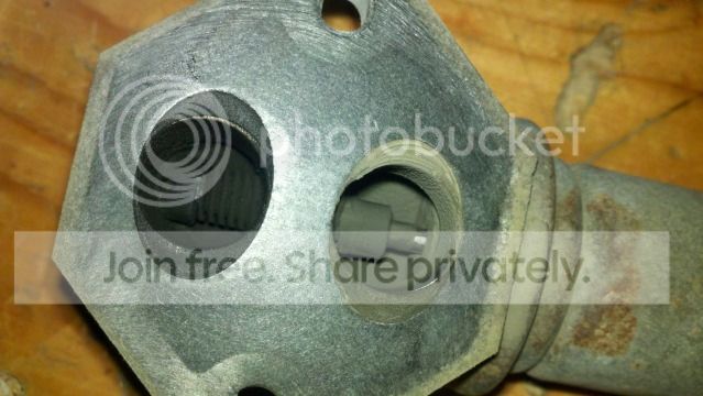

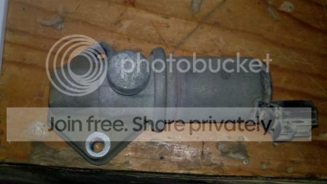

    IAC removed. (2 8mm bolts)
    Pre-Cleaning. Very dirty. Just sprayed the MAF cleaner in the holes.
    Post-Cleaning. Still not Sparkling but so much better.
    Re-Installed
