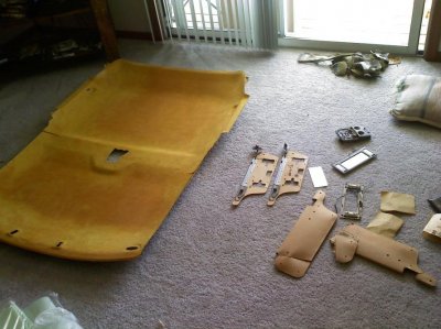

Pic 1 -striped the old headliner out and cleaned up the backer

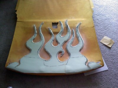

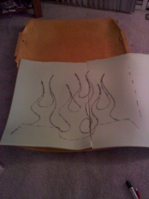

Pic 2 -I used 1'' thick foam and traced out my design (you could do anything)
Pic 3 -Used a razor blade to cut the flames out. I cut the foam at angle to make a smoother look. Then sprayed adhesive to glue the foam to the backer.

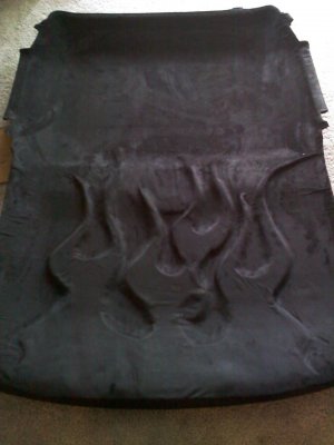

Pic 4 -Used 3m super 77 spray adhesive then layed the suede over the whole thing
and there it is :birgits_tiredcoffee
