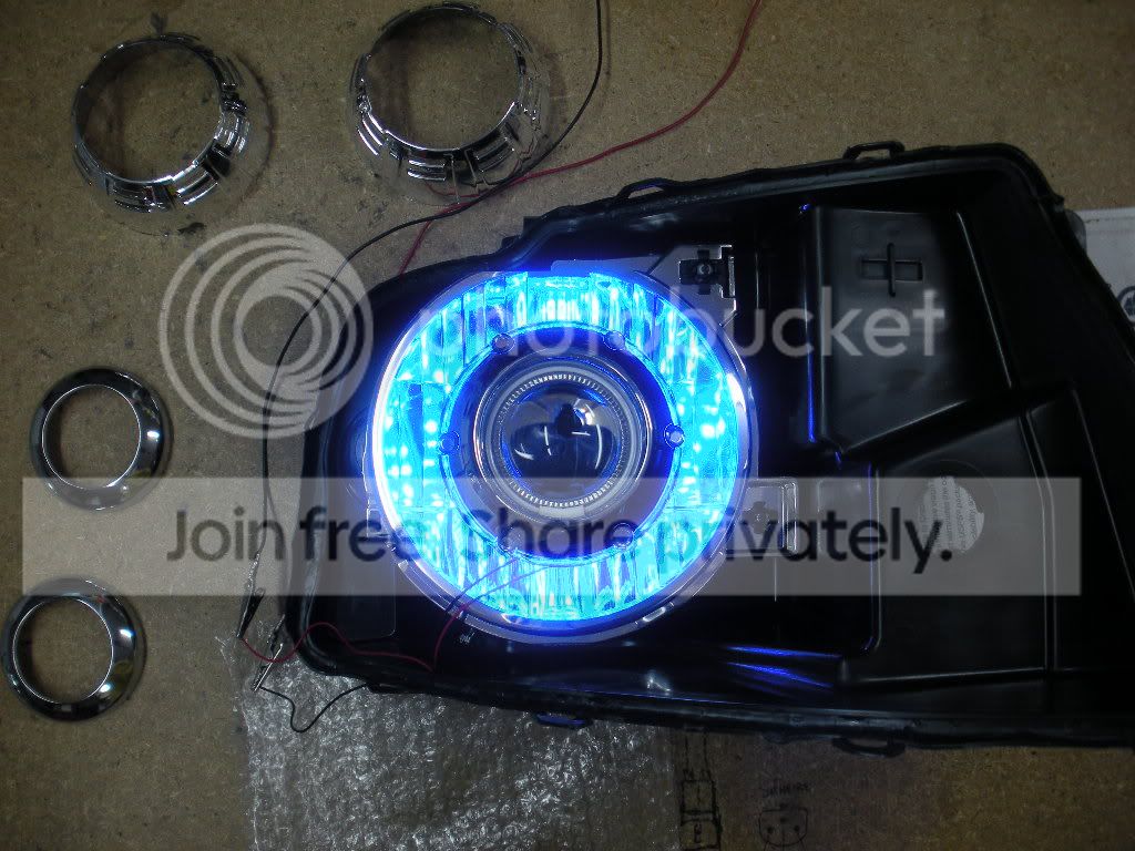

I am currently having a set of headlights being built by http://sickhids.com/. Sick is run by one guy, Brian. I contacted him on a Saturday at 1200pm and he called back within 15 min. Best customer service I have ever had. What Brian does is install a projector into your factory headlight. His products are 100% plug and play( like any standard HID kit) and lights are adjustable same as factory. I did not want to send the only set of headlights I had( on my truck) and so I had Brian buy them and put them towards the price of my finished product. ($150 for headlights through Brian) I will not quote prices because I do not know exactly what is what so I dont want to put out false info.

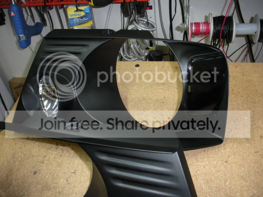

My lights will be a standard headlight housing with a smoked lends, black inside, instead of chrome. I also had him sandblast and paint the 7" chrome reflector bowl black as well. The side marker lends is also blacked out. I will have a chrome shroud with vents around the projector with 6000K leds firing through the vents. I will be running 8000K 55w HIDs through the projectors. I have projector lends over my turn signal bulb that will hide the bulb and project the signal color. When I have parking lights on only the 6000k lights behind the shroud vents and the Led switchback in 6000k will be illuminated.

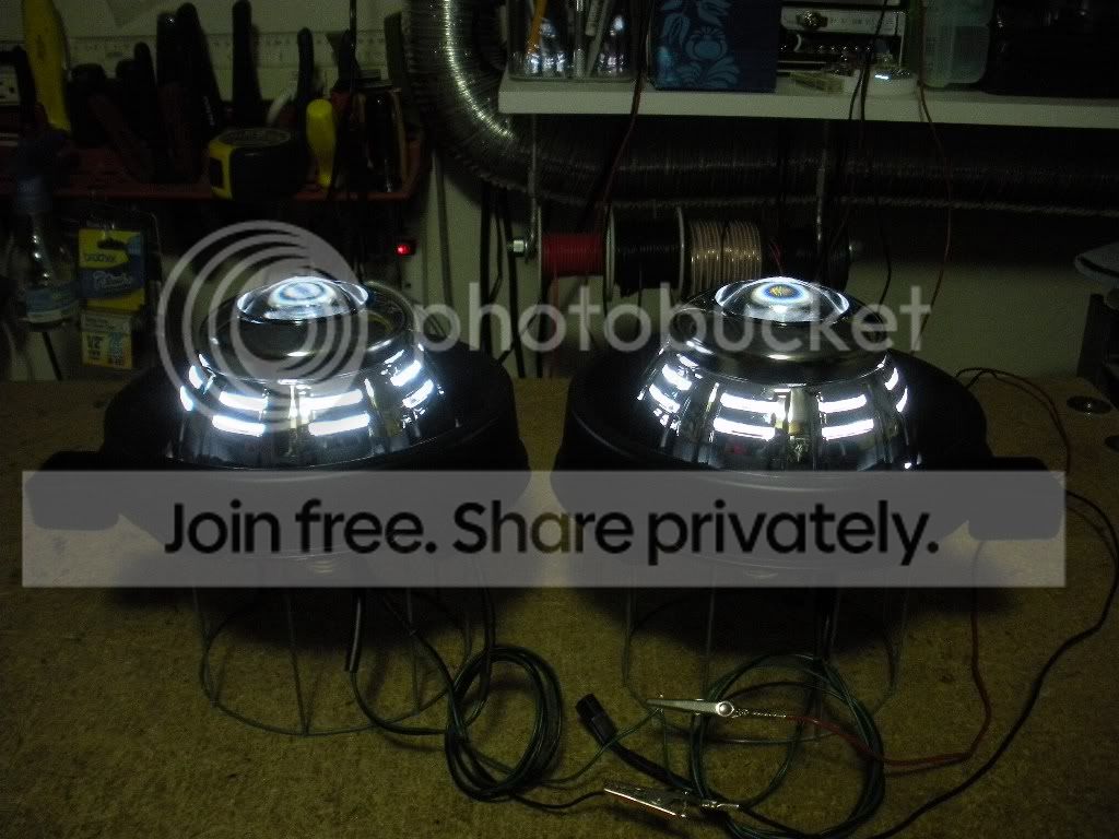

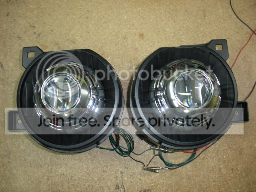

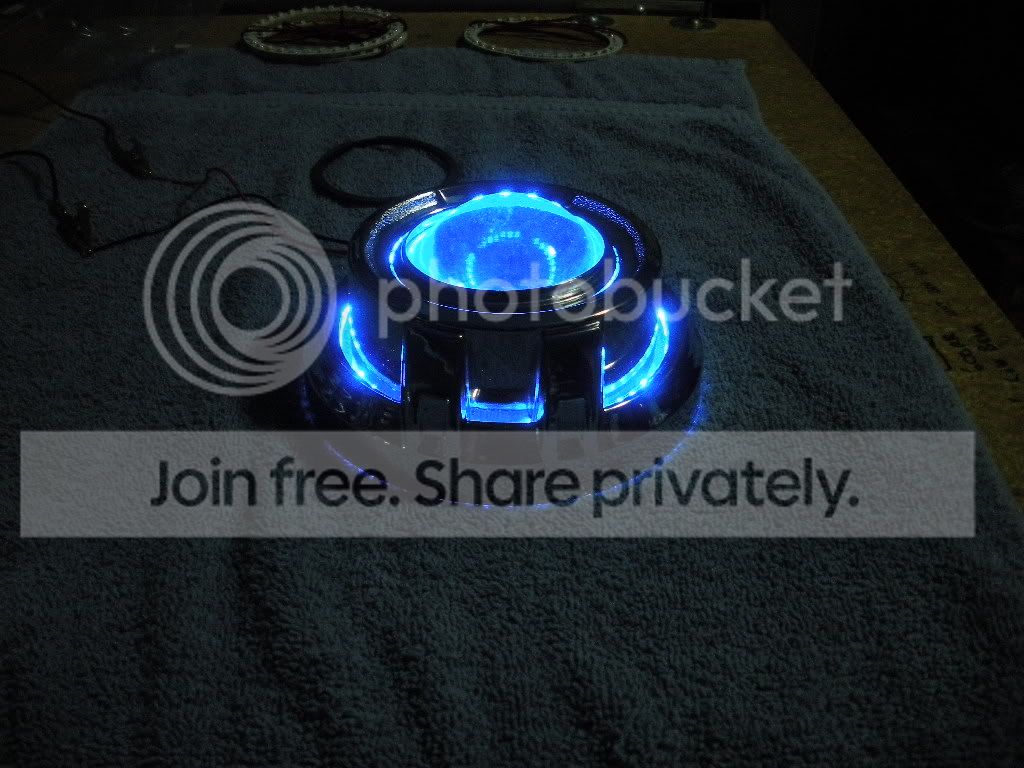

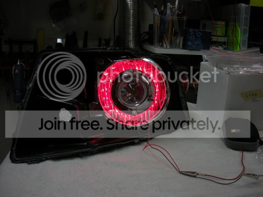

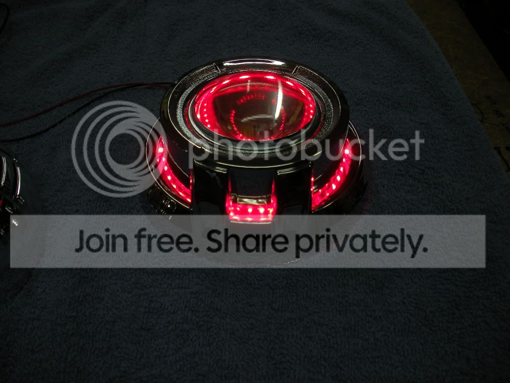

Here are some photos of finished lights for other people, options I asked for and things like that
Vents, projectors and bowls
The next few are of my projectors

I am waiting on updated photos. He is suppose to be finishing up this week!
