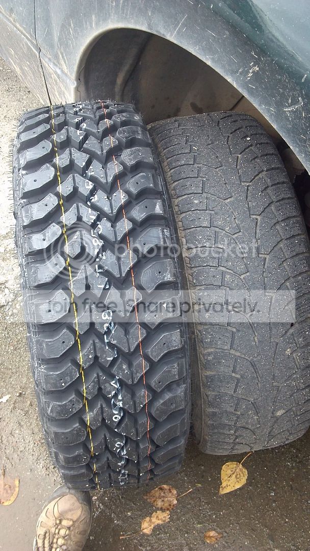

  9. ak_cowboy
    Here's 285/70 vs 265/70
