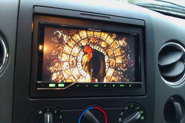

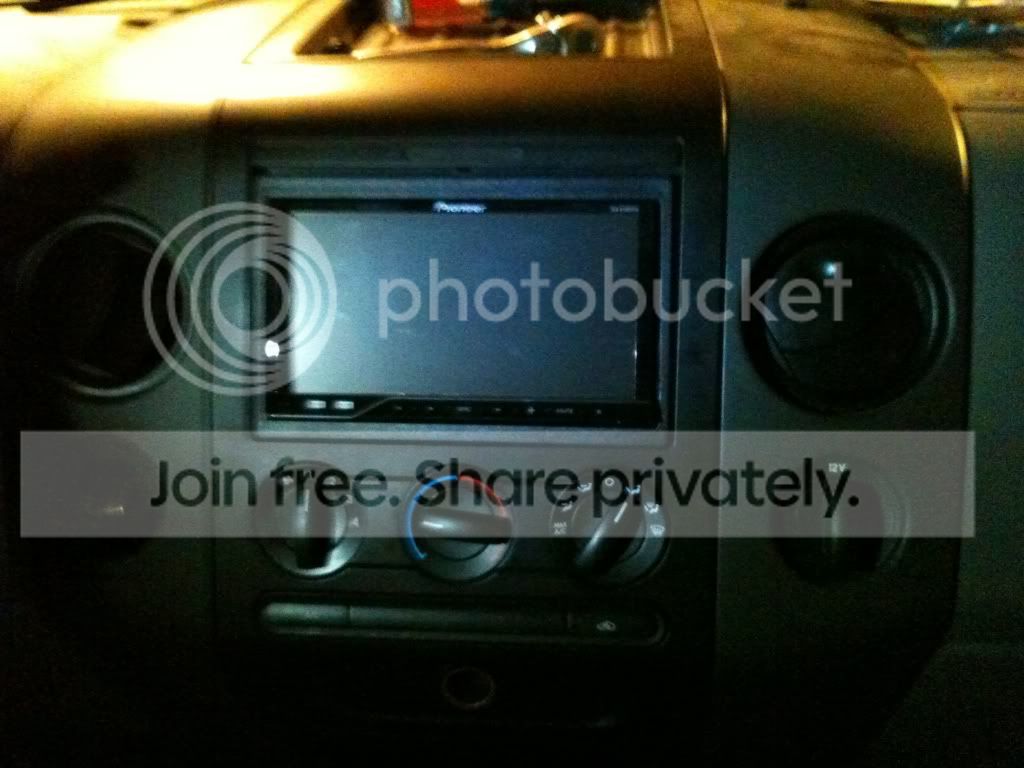

    I wouldn't try playing any more cds... Lots of guys at f150online have the 6-disc that broke and swallowed all their cds, no ejecting or playing. I bought one used last summer and had the same issue. It would read ERROR and wouldn't recognize any cds...
    You're better off getting a new headunit.
    Like the Pioneer AVH-4300!
