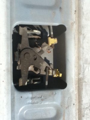

My tailgate hasnt been able to open since october, and it hasnt really bothered me til now (brake lights went out and to get to two of the screws that hold my taillight in has to have the tailgate opened) it turns out the plastic piece that holds the rod in place on the latch/handle broke...got it in there for now til I can afford the fix it properly
Now if only I could buy just the plastic piece that is broke... Sent from my iPod touch using Tapatalk
The HELP section by Motormite Our Advance Auto Parts has one that is a package of assorted types, yellow, blue, black, gray and clear. I think there is 6-8 clips in one package. Buy Dorman - Help Clips Door Linkage 75450 at Advance Auto Parts
I think he is my bro in law had that happen to his Cheby lol dumbass broke both his tailights trying to get his tailgate down and when I got there I showed him the screws from the inside. That's a Cheby owner for you
Yep...the only way I found it in the parts store is with the rod also and it's 30 bucks Sent from my iPod touch using Tapatalk
