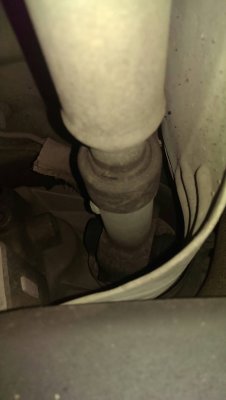

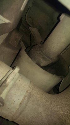

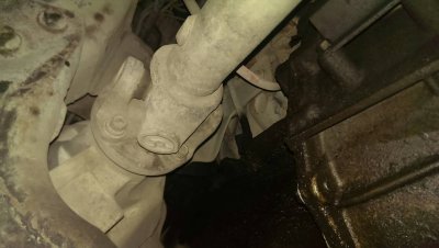

    Here's what mine was like...
    1st pic-Heat shield I removed. At the rear end of the shaft.
    2nd pic-Forward end of the shaft, real easy. Please ignore the oil leak, I'm not fixing that stupid thing.
    3rd pic-Mine just has a little rubber seal on the sliding part. Also, more of that damn heat shield.

  9. Pity7700
    yea I see you don't have a boot in your third pic, I do. it almost looks like a shock boot, just smaller.
  10. Ak 08 stx
    Ak 08 stx The Only One
    7,569
    284
    North Pole, ALASKA
    Well it looks like you should be able to just compress that and it should drop right out. In my 91 I got the same thing and all I had to do was undo some u-bolts from the front drive shaft, compress it in and it dropped right on out, but things differs in years don't know if they do that or not
