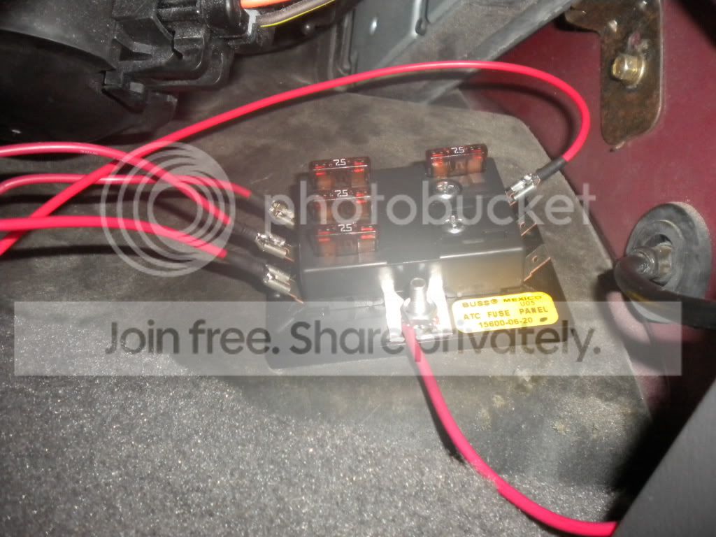

    installation was simple, all you gotta do is run power to the panel and plpug in your aux. items. the hardest part was finding a spot to mount it.
    Heres the one i bought
    + 12V power supply goes to the nut and bolt

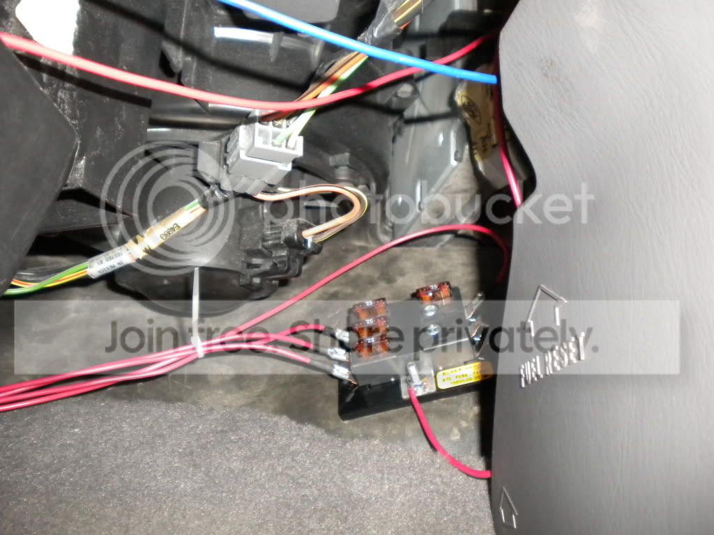

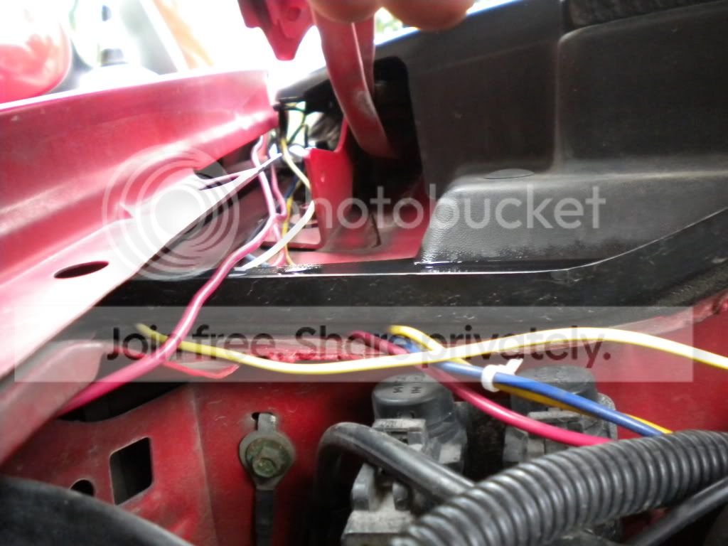

    had to pull all of my wiring out and snip all of the power wires. i originally had all power wires to the switches run to the battery with an inline fuse. way too many wires running through the door. if youre wondering why i ran them through the passesnger side door its because i dont like the wires running through the rubber gromet under the driverside dash, out to the engine and then across the top of the engine to the battery...it looks like **** IMO.
    i mounted mine under the passenger side dash and drilled into the rubber matting under the carpet. im not a big fan of drilling into metal. i hate and worry about rust. pretty sturdy where i have it mounted anyways.

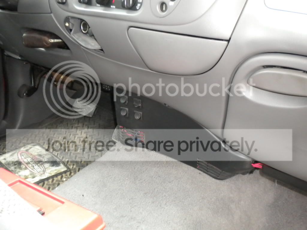

    the only thing you can see are the wires running behind the plastic piece where my switches are. the fuse block is far up underneath so that you cant see it. i like and it made everything alot cleaner.
