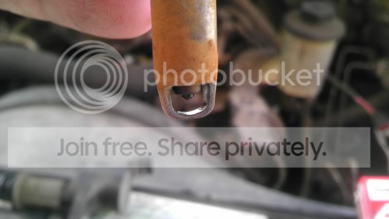

    The first one came out without a problem.

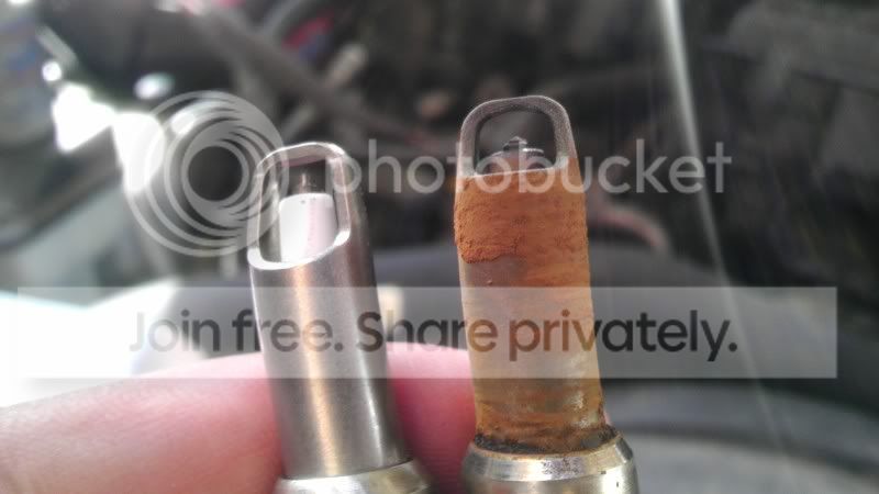

    You can see where the Techron didn't reach the carbon all the way up, its still dark black. Here is a new redesigned plug next to the original, notice how bad the electrode wore out.

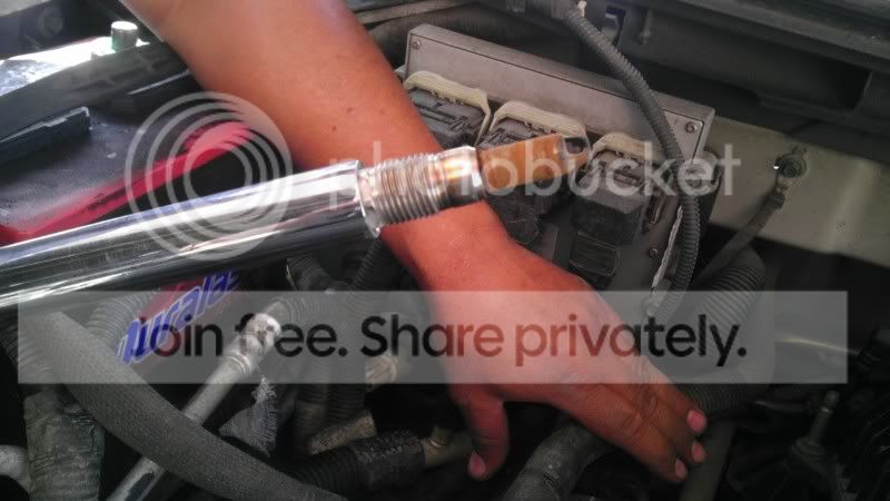

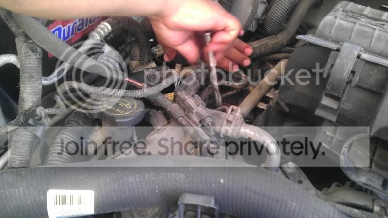

    The next 2 he loosened a 1/4 turn then tightened it back up. Loosened it again and just kept going. They both came out screeching the whole way out. The last one on the passengers side was a lot harder, I thought for sure it would break. He took his time, worked it back and forth then he said: "Oh crap!... just kidding", and took out the last plug. I damn near pooped myself. That plug alone was worth the $70 I payed him.

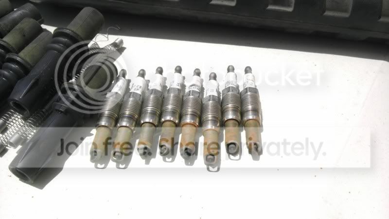

    Half way there.

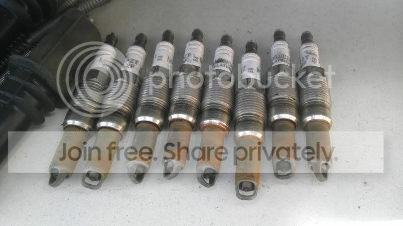

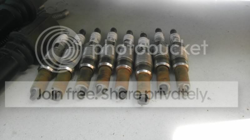

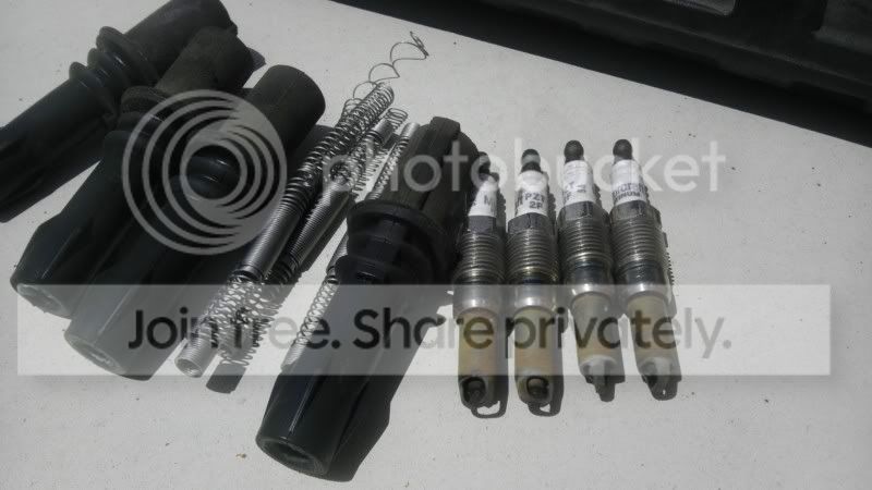

    The first 3 plugs on the driver side were pretty much the same as the 3 others, a little back and forth and they came out screeching. The last one was a bit harder but he took it out. No breaks.
    All the new plugs got nickel anti seize and new boots. Drove it to the bank, got his cash and drove back. Truck was a whole other animal! More power and smoother acceleration. It was like driving a new truck home. No hesitation or misfire whatsoever. :happy107:

    The springs that fit inside your coils look toast! At least the one does.
