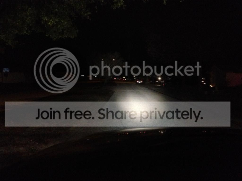

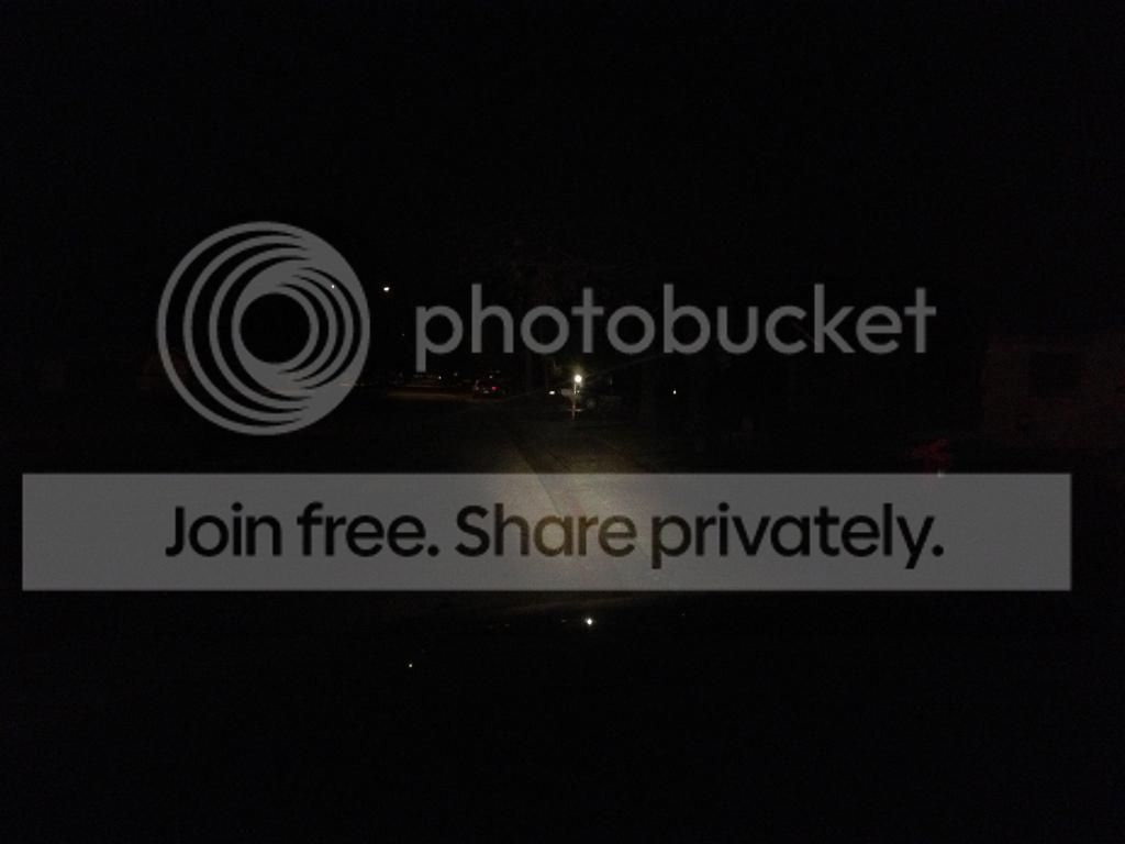

    A little update ;) Both pictures were taken without headlights, only the 100 watts
    Here is a picture from the day I shortened and cleaned up the grounds:
    And now after I installed the relay....
    SO MUCH BRIGHTER! Thanks guys for all the help!
  6. Roush PSD Interceptor
    Awesome, much brighter Taylor!

    Couldn't have done it without you guys ;) also forgot to mention that I am running 10 gauge wire throughout now
  8. Pity7700
    there you go man! much better.
