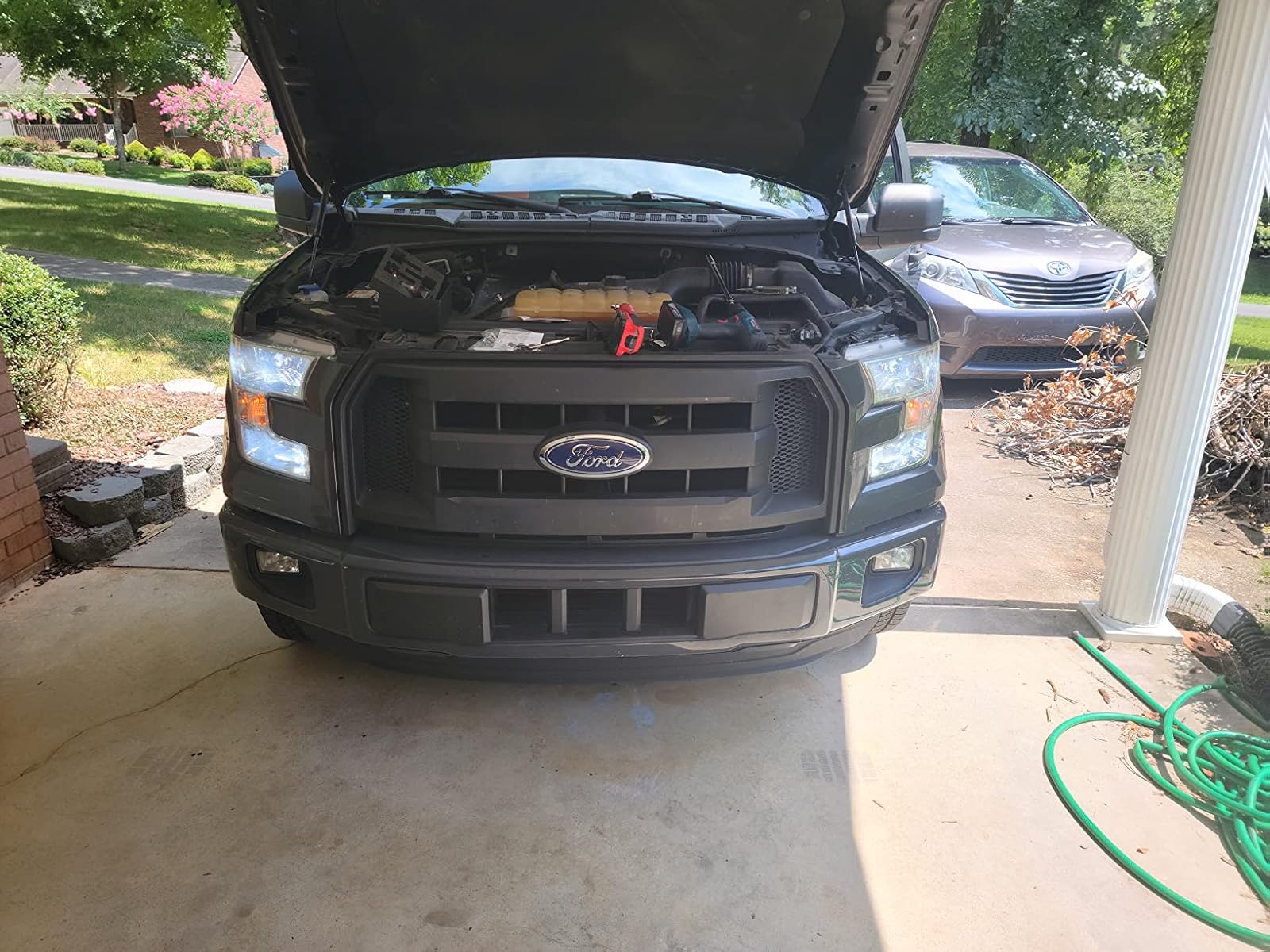

    I Just swap these AUXITO LED bulbs in my 2016 F150 XL after having one of the halogen lights burn out already. The install is quite easy with a little patience and common sense. As in the online videos, remove a few screws in the fender well, pull back the liner, (I used a stick to hold it back), remove the dust covers, remove the socket/bulb, plug in new bulb, replace socket/dust cover, screw back fender well, done. Nice and bright, good light pattern. No more dim and dull.
