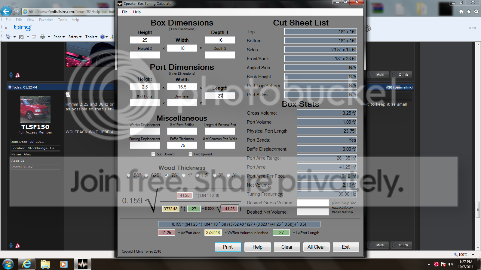

    After subtracting the port volume I have 2.16 cubes minus the .16 for the sube im left with 2 cubes at 39.9Hz

    Oh and for the people asking about the calculator im using here it is..
    Torres' Box Tuning Calculator - SMD Forum
    Make sure to and .exe to the end when you save it.. or it wont work..

    It was suppose to be 2.20 ft3 after all displacments and tuned to 38hz..
    But due to a mistake on my part with the port I lost 3/4 inch of height which makes the box 2.10ft3 @ 39hz oh well still gotta be better than what I got..
