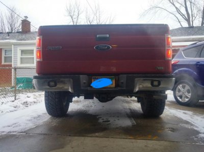

here she is guys!

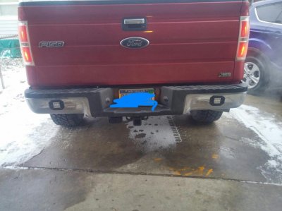

  9. Pity7700
    Got em mounted. Just need to clean the holes in the bumper up with a grinding wheel and make sure they're mounted straight. Gotta wire them up too.
  10. Roush PSD Interceptor
    Looks great Chris.
