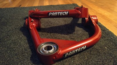

    Ordered some fabtech uniball uppers. $550, not too bad.
    Gotta get them done before heading north on the 15th for deer season. Driver side is getting worse.

  3. Pity7700
    As soon as I get em!
    Thinking about painting them to match, not sure how if it'll stick to the powder coat though.
  4. Roush PSD Interceptor
    59
    Scotch Brite pad them, then paint with enamel.
    Pity7700 likes this.

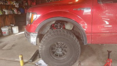

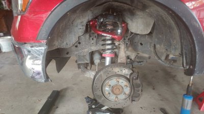

    Got em all painted. Roughed em up real good with a body prep sanding block, wiped em down with an alcohol prep pad from work, 2 coats of automotive primer, around 5 coats of duplicolor perfect match paint, had to use the paint for my 96 F150. I can't find touch up paint for my paint code (U6). The paint on my 96 is so close to the 2010. Won't even notice it under the truck. Finished it off with 2 light coats and 1 heavy coat of automotive clear.
  7. Pity7700
    Looks pretty good!
